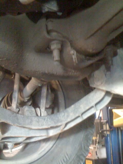

Looks like the axle seal is fo schizz. I had to top off the front diff because it was really low. The last time I was under there was in May when the fluids were changed and it wasn't like that then. I'm not sure it has anything to do with the noise I haven't heard again in two days but it's obviously a problem.
