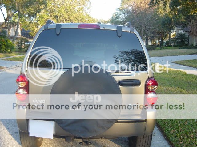

Yep, that's right :pepper: Nice and high, hidden and cheaper than I could have made one for! Just had to trim a small piece of pinch weld. :pepper: THANK YOU WILDMAN! :JEEPIN:

Looks great...now I see why Mudd wants one... :-)r
Not to burst your bubble...but it's no more hidden than the OEM KJ one mine had from the factory:

It is when you cut 5 inches off the bottom of the bumper! :ROTFL:

Yep mine sits much higher than a KJ MOPAR hitch. :BANANA: :JEEPIN:

Reminder, KK and Nitro use the same hitch so when looking for used check out used Nitro parts too.
 Post subject: Re: KK Hitch on a KJ
PostPosted: Fri Sep 17, 2010 3:47 pm
Can you use the hitch though? Ive got a draw-tite hitch with a longer neck but still all of the trailers we have barely fit between the ball and the spare tire. Cant imagine any of our trailers working with that hitch. Dont really want to get a longer receiver since some of our trailers have a high tongue weight. Even with my air suspension and OME HD springs it will sit level. Think our camper is almost 400lbs loaded.
PostPosted: Fri Sep 17, 2010 3:57 pm
Lift it more Jeepster :wink: :BANANA:
I have to run at least a 3 inch drop now for my trailers to sit level. With that hitch I'll be running a 4 to 5 inch drop hitch, plenty of room!
Please note;
A KK hitch on a KJ is not for everyone
only those who are Muddified and lifted or soon to be !
:twisted: :twisted: :twisted:
:ROTFL: :ROTFL: :ROTFL: :ROTFL:
PostPosted: Fri Sep 17, 2010 4:08 pm
Gotcha, didnt think about some needing to use a drop. Right now mine just has a 2inch drop and all of the trailers sit level. Those tires you have really lift it up more than mine.
