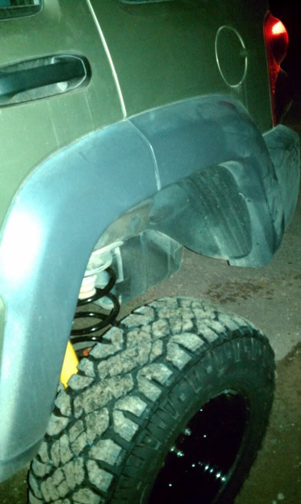

got it all done. the rear was way easy ha ha. didnt use a single drill bit mounting the pucks either :wink: self tapping screws work wonders. seriously 4 seconds of drilling and i got a #14 self tapper through. gotta say it, i like it a lot now. couldnt stand the color before but now it looks good
poser shots
got an appointment to get it aligned tomorrow. i do have to go back and do some trimming :D it rubs a lot ha ha
31-10.5-15 duratracs on 15x8 cragars with above mentioned lift and long tall texan spacers in the rear. i'll get more pics tomorrow in the light
