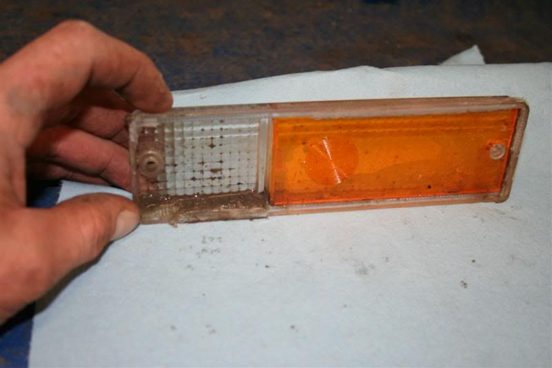

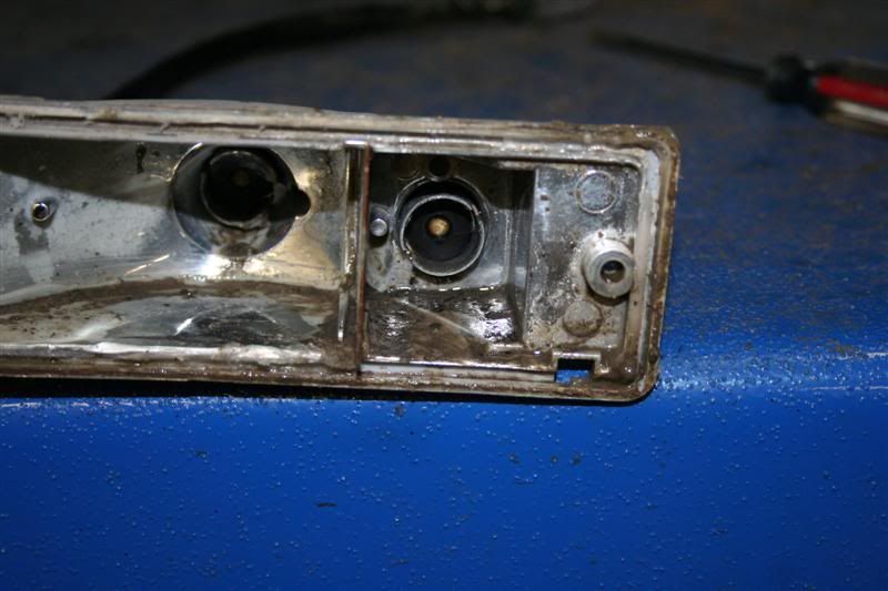

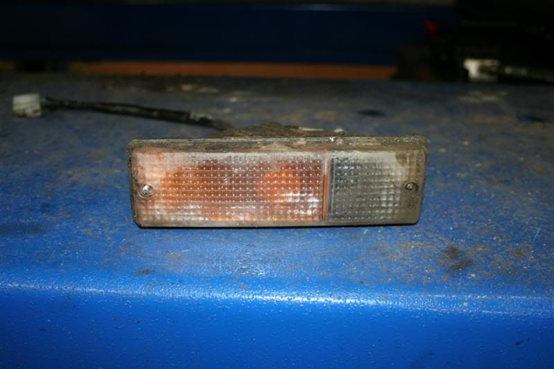

So, like the title says, I've an ARB bumper on my '05 Renegade. I'm having trouble keeping dirt/mud/water out of the turn signal lamp assemblies that came with the bumper. Check the pics out to see what I mean.
With the lens off...
Inside of the lens...
Anybody know of any replacement lamp assemblies or a sure fire way to seal these up? I put a hefty bead of clear silicone around the lens to lamp mating surface and a dollup of the same on the backside where the "vents" are. I'll see how well it holds up next time I go wheeling. In the mean time, if anyone has any good ideas, post them up!!
Truthfully, I'm kinda pissed that the lamps aren't watertight and that the connectors they come with aren't sealed up at all either. Man, you'd think that for the premium ARB expects us to pay for a bumper that they'd put in some decent lights.
Ian
