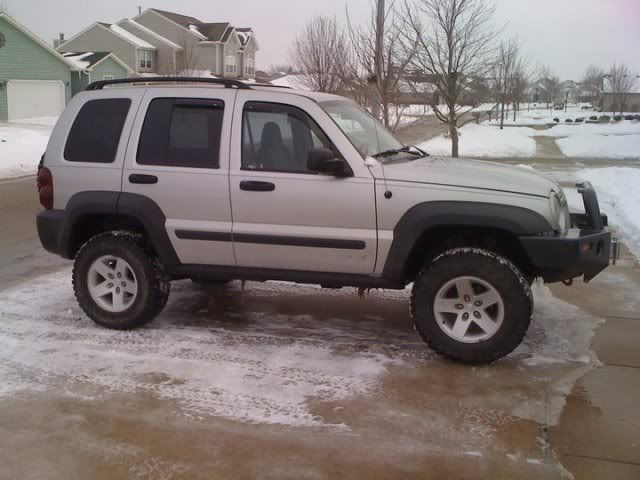

I have a similar lift on my crd, front ome 790's, top plates, 3 ring clevis, and arb bumper with warn m8000. rear is ome with one extra iso each side. Measured at 21.5 front and 22 rear if I remember correct. Heres is a pic with 245-75-16's
06 Jeep Liberty CRD

Like I said in the other thread...this stuff is too much. You'll sit too tall. I'm at 22" in the front with 790s alone. My coils are dangerously close to hitting the arms. If I were you, I'd ditch all the spacers on your list and use ONLY springs. You might need one extra pair of ISOLATORS in the rear to level it out according to some forum members, but I haven't gotten the chance to do my rear coils yet so I can't say for sure.
If you put all that stuff on a CRD you're going to kill your joints.

If your planning on a ARB bumper and a winch in the near future save the spacers, you may need them. You dangle 160+lbs off the front end it tends to sag things a bit. Again, I have a CRD with the arb/winch and I am at 21.5" with spacer plate and 3 ring clevis.
06 Jeep Liberty CRD
