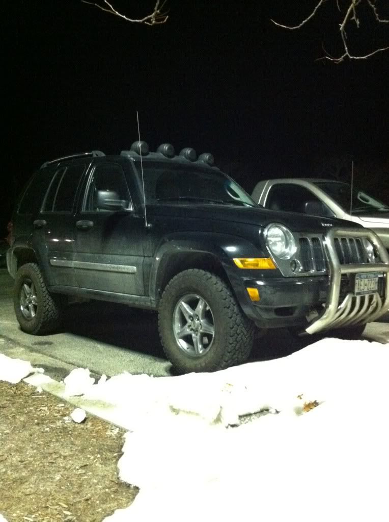

I have exactly what you want. Frankenlifted with 265-70-16's. After the frankenlift it was up about 3-3.5 inches from stock(including the sag from 145,xxx miles of highway). Then when i went to put the 265-70-16's on the stock rims, they fit just fine, just a bit difficult to balance. When they got mounted they rubbed on the upper control arm. So i ordered 1.25 inch spacers and put one on each hub. That brought everything out nice and good but then rubbed on the pinch and the fog light door.
Pound the pinch down flat, and then cut out the fog light door and you should clear perfectly. I have a couple pictures of my CRD as it sits now.
This was before the spacers
and after the spacers.

I got the premium franken lift, expensive, but i figured its worth it since a buddy was doing it for cheap. As for the bullbar, im really not sure my dad put it on when he got the car 5 years ago. It doesnt have any distinguishing marks or labels on it so im sorry that i cant really help there :|
