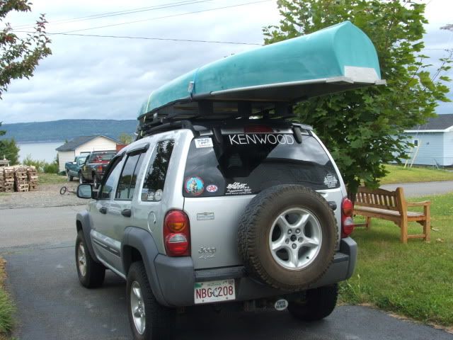

I tried hanging a 33" spare tire on my rear tailgate for the heck of it. Looked great but it was too heavy and dented the sheet metal a bit.
Right now I'm hanging a 245/75R16 tire on a stock rim with no problems. I've also flipped the tire carrier over so the flip glass doesn't hit the spare tire. It can happen.
