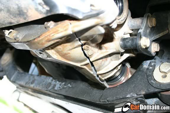

Went to the Superlift Park in Hot Springs, AR this weekend for MidSouth Jeeps one year anniversary trail ride and cookout. Everyone was impressed with the Liberty's handling and off-road prowess in spots that even TJs needed help. But soon enough reality hit in. Friday and Friday night trail rides went great and so did Saturday mornings. HOWEVER!!! Saturday afternoon whilst climbing a steep hill along the Power Wagon Point trail I got the front wheels airborn and when they came back down the front diff imploded. Cracked in half thus losing 4wd for good. Before I could even open the door after hearing the KAPOW!!! the fluid had already leaked all the way out towards the door.
I took it out of 4wd and reversed out of the trail and made it back to camp slowly. Upon arrival I started taking the front driveshaft off so I would be able to drive home today without the front diff gears causing the driveshaft to lock up for whatever reason and thus making the t-case get damaged as well. Taking the Jeep to the dealer tomorrow morning. They happen to be the Jeep Clubs sponsor too. Hopefully they'll treat me well under warranty. Just broke 22,000 miles too. Was able to drive home at around 70mph too from Hot Springs to Memphis...say a prayer the dealer is kind....laters...

Did you have the collar on it?

Tokyo....I didn't have a collar on it...i was wondering that after it happened if it would have helped any...i guess i'll never know...well i mean i could find out again if someone wants to donate a collar and 2 new diffs to me...lol
What are you refering to as the collar? pics?

JHCRASH wrote:
This collar MIGHT prevent the case from cracking. I don't think it's been proven, yet!
A cracked differential case might look like this.

The dealer is repairing it under warranty. Get this though, originally it was gunna take 5-7 business days to get the part to Memphis and they were not going to give me a loaner or rental car. However they said for $100 it could be shipped quicker so you wouldn't be w/out your Jeep for longer then you have to...WTF?!?!?! Thus I called the Chrysler Customer Service # in the warranty book and told them what the dealer said about the part could be there quicker and they were like "WTF, they are crazy to say that to a customer. It's about getting the customer back on the road as soon as possible. Did they offer you a rental car?" Well no they wouldn't give me one if thats what your asking I did ask if they would since I have work and have school. "Well they are in trouble now, because of what they said I'll make darn sure they get you a rental car and that its for the duration of the time they are repairing it and they fill it up for you. Make sure to leave it empty too when you turn it in to them too."
So now I'm getting the part hopefully by Wed. and the Jeep repaired before the weekend. Not to mention a free rental car for the week. YIPPEE
