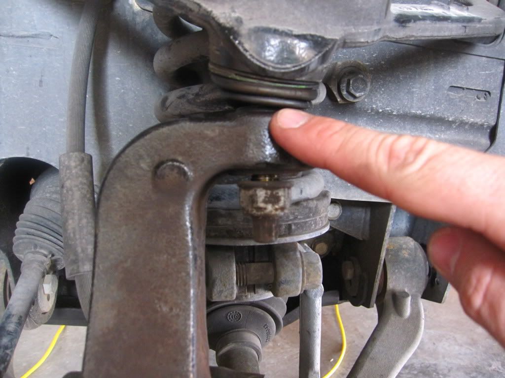

Just to be sure - hitting part where I'm pointing... PB Blaster has been on for hours. PB blaster isn't doing much on the side in the photo as the boot is not torn. What am I missing..?
Jonathan
'02 Limited
 Post subject: Re: Help!!!! UCA removal
PostPosted: Sun Mar 06, 2011 12:55 pm
Only in a Jeep!
Only in a Jeep!
Posts: 3966
Put your @ss into it and hit the thing!
Mudd can do it in one whack......and he's like 80!
And you won't see it move MM or CM... It'll just POP out... Hence why you put the nut back on.... To stop the knuckle from falling down...
Make sure that nut came all the way off first and then put it back on..... Or you will have a hell of a time trying to get it off after the ball joint has seperated.
2000 Cherokee Trail Hawk

Ha, ha! I've been a long-time lurker, so I feel honored to have my ba!!s busted using Mr. Mudd. I'm using a 2.5 lb dead blow - not enough umpfff...? Trip to Lowes forthcoming, I guess.
Jonathan
'02 Limited
PostPosted: Sun Mar 06, 2011 1:04 pm
Only in a Jeep!
Only in a Jeep!
Posts: 3966
Hit it on the bend of the knuckle.... about an inch to the left of your finger....

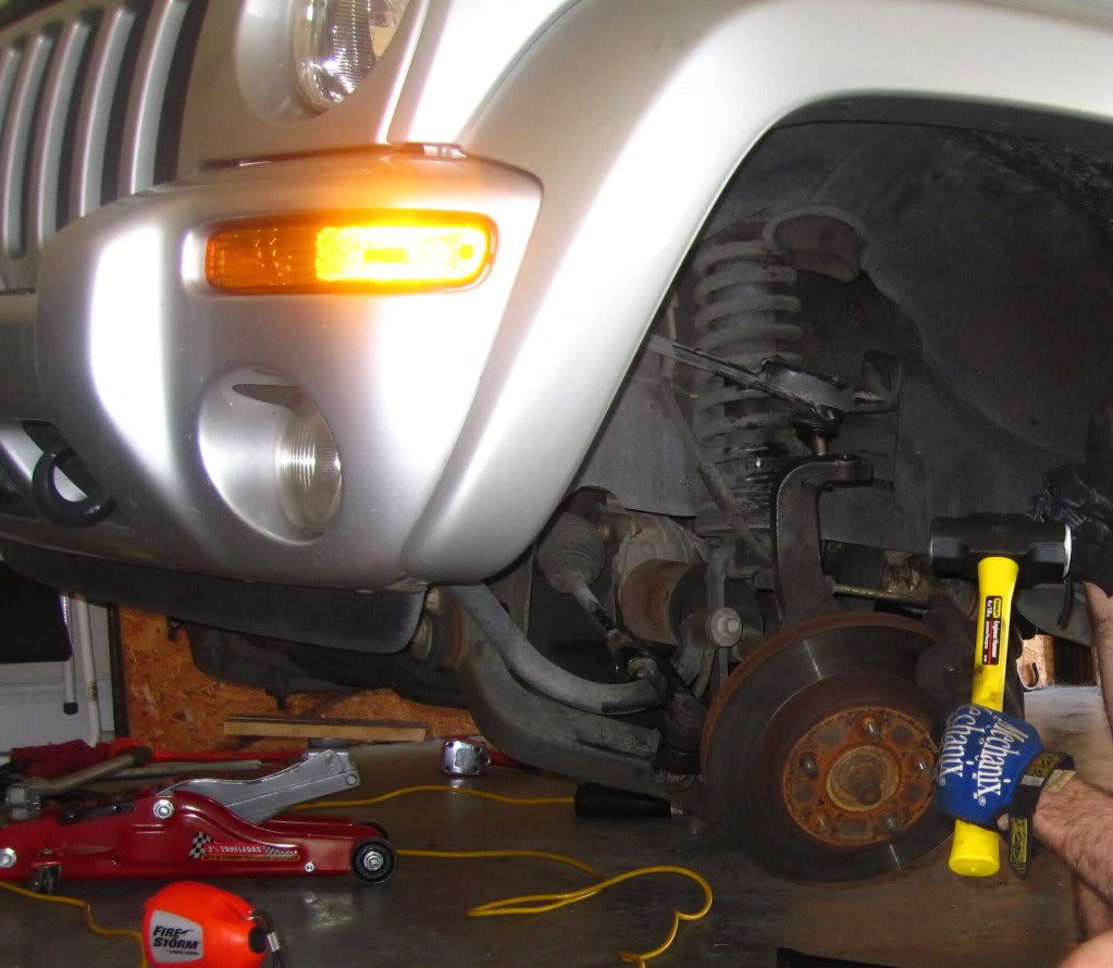

Thank you both for the assist.... Included a pic of the new 'tool'. Amazing - I messed with this thing for the last 7 hours; 2 hits, and there she sits. Thanks again guys

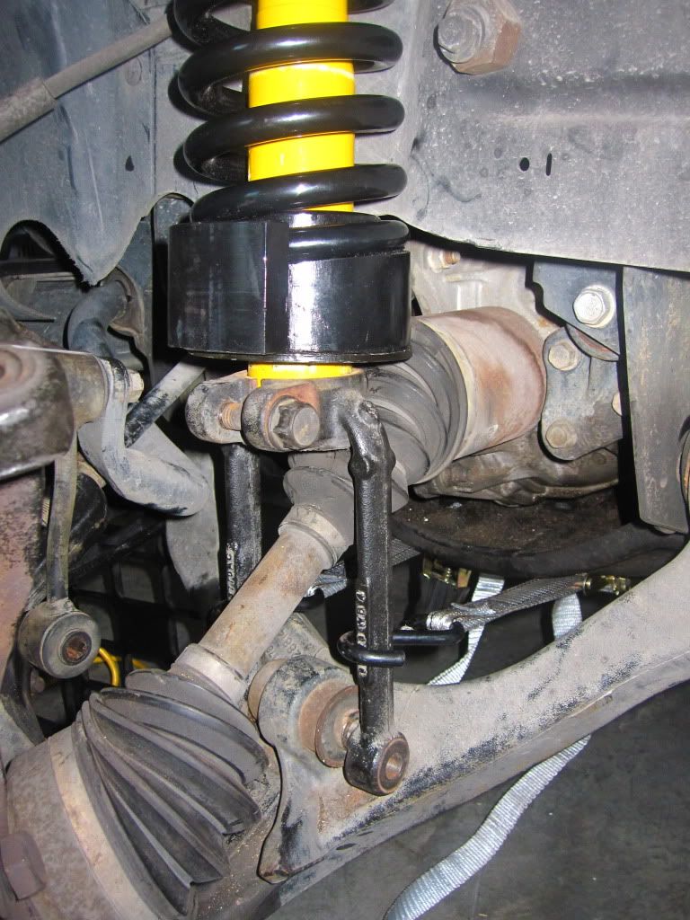

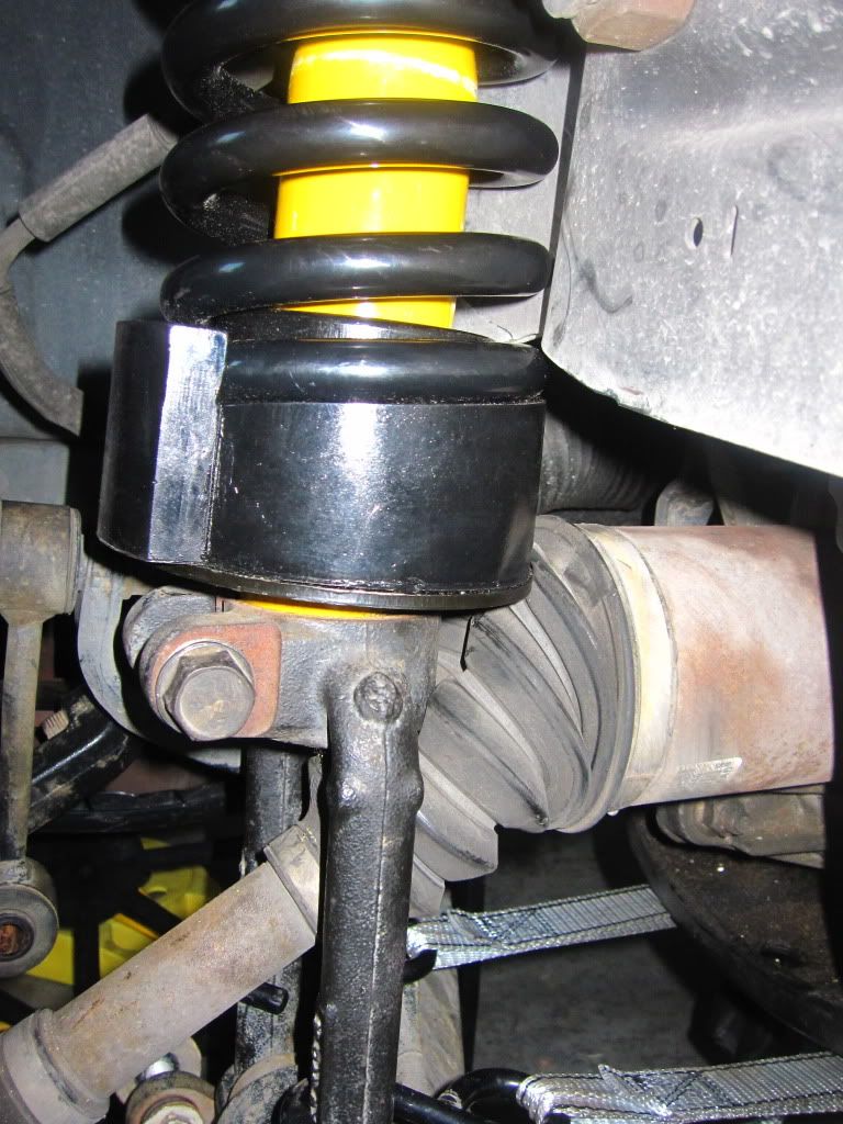

 Post subject: Re: Help!!!! UCA removal - More help needed!!
PostPosted: Sun Mar 06, 2011 6:51 pm
Joined: Sun Mar 06, 2011 12:12 pm
Posts: 12
Location: Richmond Hill, GA
I should have followed my gut this AM (a very long time ago) when I began this project - should have left well enough alone. I have rebuilt numerous motorcycles, so I consider myself fairly mechanically inclined. What the eff is going on here - look at the extreme angle needed by my lower control arm to try to get the lower clevis aligned. I'm surely going to damage something - if I already haven't. I literally can't move it any more - I don't see how I can possibly get the clevis aligned. If I could compress the spring, it would work I think, but at full extension. I'm at a loss.... my poor Libby...save me again guys....
Jonathan
'02 Limited
PostPosted: Sun Mar 06, 2011 6:58 pm
Well for one thing loosen it back up some and wrap that CV with a heavy rag so you don't damage the boot.
Next the rachet straps ( if heavy enough ) will pull them in. Now you do have a "ear" above the hole on each LCA where the bolt goes through, that will sometimes hang you up a little so it will not pop into place. Trust me it will go, been there a " few" times my self, no fun crawling under to tighten the rachet strap, climb out to use a pry bar to pop it into place , but again it will go.
Just make sure on the drivers side you wrap the CV boot up to prevent it from tearing.
You'll get it, I know you will
I'll keep checking back every now and again on ya! :wink:
and get the straps down as far as possible on the clevis, it does help some

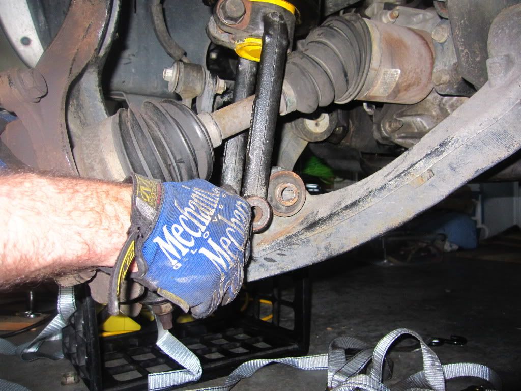

PostPosted: Sun Mar 06, 2011 7:14 pm
Posts: 12
Thanks for the help - again. I'm trying to believe every word - kind of like when I first learned to change motorcycle tires. I was told "if you're struggling, you're not using the proper technique". The first time or two, there was no way I was believing that advice, but sure enough, once I learned what I was doing, it was good advice. One more photo to show how much further I have to go - I can't get the lower arm any lower and I'm still this far off... Taking the wife to dinner to take a breather. Again, I really appreciate the help.
Jonathan
'02 Limited
PostPosted: Sun Mar 06, 2011 7:42 pm
Yes you'll be off that far without anything holding it, the drivers side is the worst, has been on everyone I've been involved in as far as getting it back in. ( this goes for Frankys and our modified ones)
But it will go, as many times as I've had mine apart there has been a few times when I thought there is no way, but it went.
Hope you had a nice relaxing dinner!
PostPosted: Sun Mar 06, 2011 8:34 pm
Joined: Sat Nov 20, 2010 12:26 pm
Posts: 271
Location: Palm Desert, CA
Assuming you are doing this by yourself, really sucks.
We ran into similar issues when we did ours (doesn't everyone). As Tom mentioned, loosen up the clevis nut so that it will turn and make sure it is all the way to the top(it doesn't look like it is in your pictures). Make sure that the 4 nuts/bolts holding in the strut are also loose. We pulled one side in and put a screwdriver throught the clevis into the hole. Then we pulled the other side in and got the bolt started and were able to hammer it though pushing out the screwdriver.
The other side is easier :)
2004 KJ Limited
