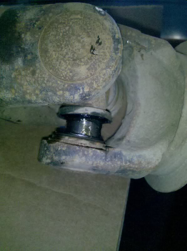

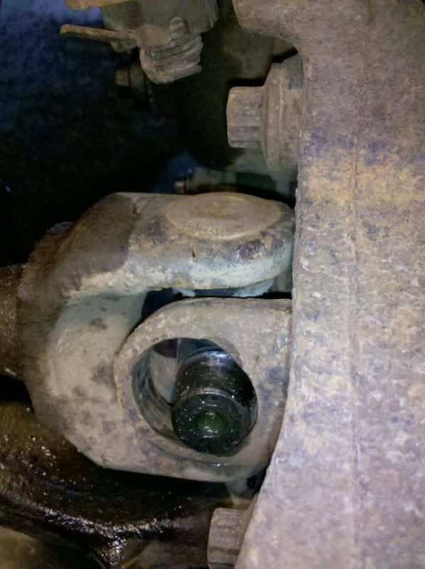

i had a popping issue in my XJ and found this:
pulled the driver side shaft today and found this
as it was in the Jeep:
removed showing the other side:

OK I found out what it was! :BANANA: My friend is a mechanic at a local chevy dealer so I took it up there after hours and we tore it apart. I couldn't get any pictures on my own, but I found some on the net that will show. The front driveshaft CV joint that connects on the T Case end seal broke, so I need a new CV joint. Cheapest I found was about $70 plus shipping.
