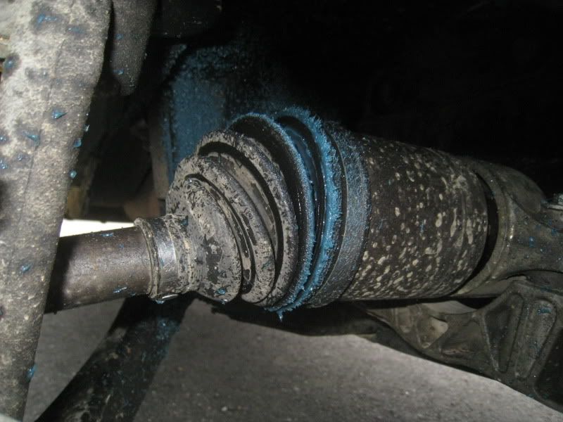

It's hard to tell, but here are a couple I had.
This is when I had a little hole in the boot.
This was my temporary fix.
This is to much air in the boot from NAPA.
This is when the boot ripped completely through.
-dbk

 Post subject: Re: Ideas to lower lift slightly?????
PostPosted: Sun May 15, 2011 12:06 pm
Joined: Sat May 27, 2006 12:41 pm
Posts: 132
Location: NJ
Infernicus,
Are those pics with tire on the ground? How often do you go thru boots? Have you been able to do anything to make boots last?Your first pic looks like mine does.
The pic that says it has too much air looks like it wouldn't rub against itself as much.

Posts: 1778
Location: Queens, New York
I posted something on the boots, I thought it was this thread. Apparently not, lol.
All the pictures are with my Jeep on the ground. And shooting slightly upward.
I've only replaced my CV once. I only replaced one boot. It was the NAPA boot.
One boot ripped on my original CV, I don't know how it happened, and I didn't catch it early enough so I had to replace the CV.
The second rip was from the NAPA CV. The boots are noticeably thinner than the Mopar boots. It is definitely possible that I pinched the boot on the inside when installing the new CV, and over time it ripped completely through.
When I replaced just the boot on the replacement CV, I used the Mopar boots because it was worth the extra money (they were only about $35).
-dbk
