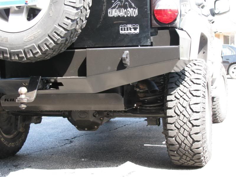

heres what a Moab looks like as far as sitting in the rear fender ( with 265-75s
heres one with 265-70s sitting on the Moabs kind of give you an idea
