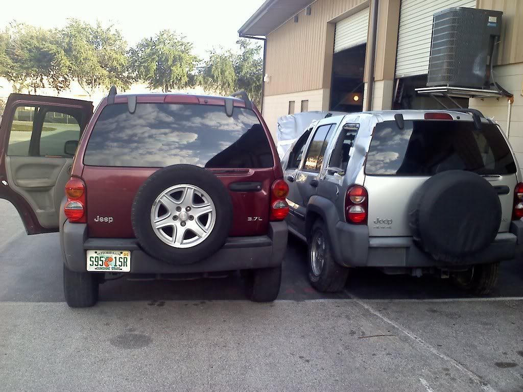

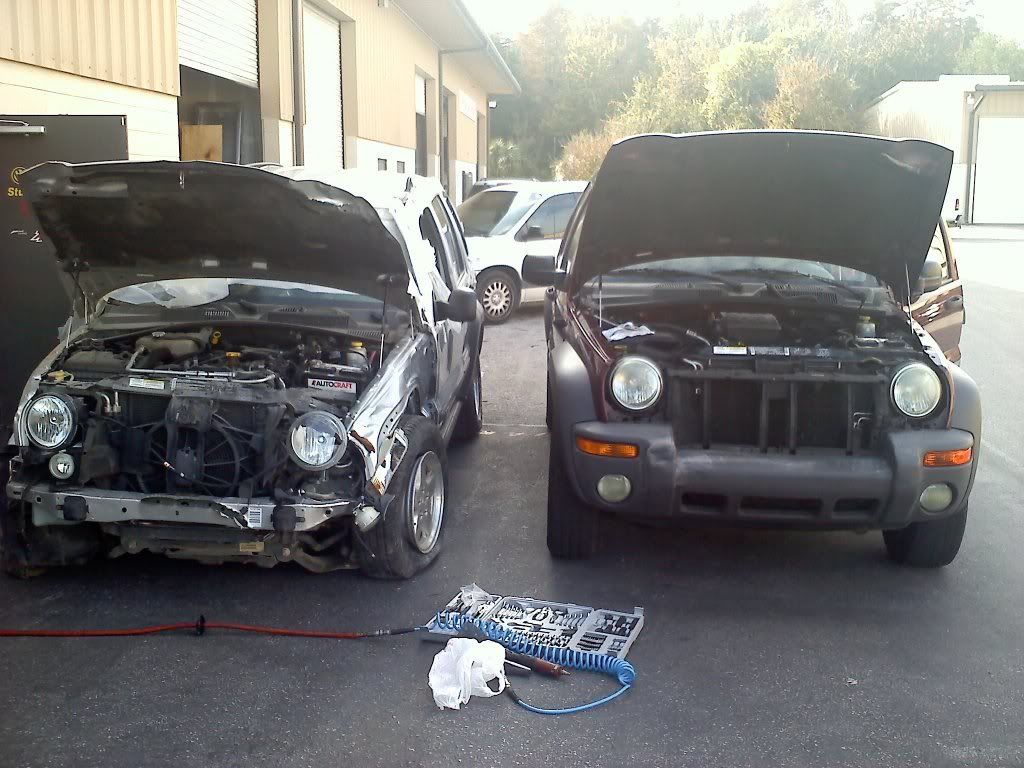

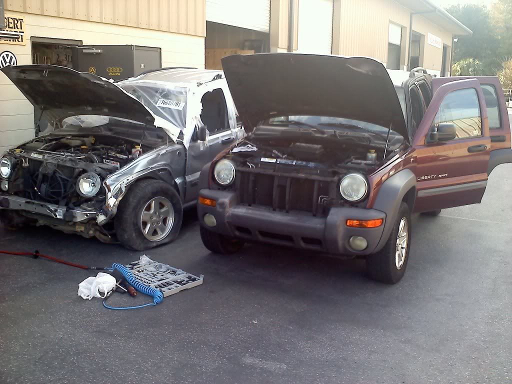

I bought the 02 gasser last week specifically for swapping in the diesel. It has at least a head gasket issue and maybe lower end problems as well. So far I've drained the fluids and removed the exhaust. Green slime (oil and coolant) bled from the crankcase AND exhaust (no wonder it didn't want to run). The engine might be revivable but I really don't care as I live in a no spark plug zone.
The CRD is a rollover - the only undamaged panel is the tailgate and as luck would have it the only damaged panel on the gasser is the tailgate so that will get swapped too. Also the 05 interior, radio, steering column, maybe the carpet.... The unibody is damaged all over and will be scrapped.
The gasser is already setup for 4X4 (crossmember has cutout for shaft, front wheel hubs are splined to accept shafts) but we will probably just replace the whole drivetrain. The subframes are easily swapped. Mechanic (who is an EXPERT fabricator, engine builder, etc. - he gets personalized holiday greeting cards from Bentley publishers for being a beta tester) says it might be easiest to just pull the old drivetrain out the front and slide the CRD in. Shouldn't be a difficult job just mostly tedious and the biggest PITA will probably be the harness. Any fabrication will be a piece of cake.
Seems like swaps tend to scare members here. This shouldn't be a big deal, the 2.8 was a stock option as was the 3.7. They were both fit to the same vehicle by design. We already swapped a 1.9 VW TDI into a gasser boat and had to fabricate nearly everything (complete closed cooling system, exhaust, steering, throttle [TDIs are DriveByWire], water to air intercooler) as well as deal with the electronics. Next is a mini Cummins (4BT) into a 02 4.7 Dodge Dakota which should be much more complex (will need an NV3500, mounts, adapters, etc.) but still not so bad (Jeff Daniels Jeep makes a conversion kit for the new Wrangler which will work with the 02 Dakota, both being Chrysler - keeping the stock PCM, instrument panel, no CELs). I look at this swap as a "break" in between the two.
I've got about $4K into the project so far and expect another $1k, maybe $1500, by the time it is on the road, depending on how much work I do and how much I leave for my mechanic. Not to mention selling the old drivetrain parts and scrapping the CRD carcass for hundreds. Regardless, it will be several THOUSANDS less than what I would have to have paid to buy a CRD. That means more money for those oh so necessary performance enhancements.

 Post subject: Re: 05 4X4 CRD into 02 Liberty 4X2
PostPosted: Sun Dec 11, 2011 3:17 am
Joined: Sat Aug 13, 2011 11:13 pm
Posts: 35
Location: Tampa, FL
NewOldTimer wrote:
If sheet metal is the only damage, why not just remove the body panels from the gasser
and install on the CRD. If the roof and unibody aren't badly damaged, a little body work,
new fenders, doors, rear gate, etc.
IMHO, the easiest way to accomplish this if you're intent on doing it.
I think the pics will speak for themselves.
http://s279.photobucket.com/albums/kk13 ... 20Liberty/
2002 Jeep Liberty CRD 2.8L diesel (perhaps unique in USA)
