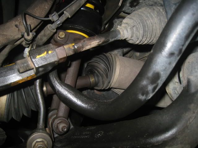

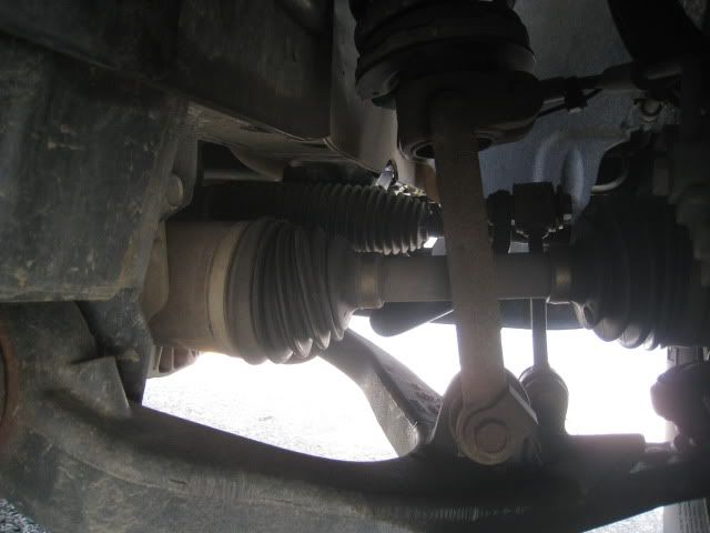

The stock factory springs sag pretty quickly, they say after 30k miles you've actually lost lift.
At ~58k when I put my lift in I was about an inch and change under stock.
Stock height is 19 inches from center of wheel to bottom of fender flare.
I put in the Frankenlift II with JBA A-Arms.
Here are a couple shots of my CVs:
BEFORE;
AFTER;
The night of lift install, before alignment
Around 10k miles after lift installed (Ignore the torn boot)
-dbk
4.10s sitting in a box - 3
Sold-1988 Suzuki Samurai
