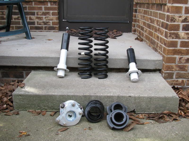

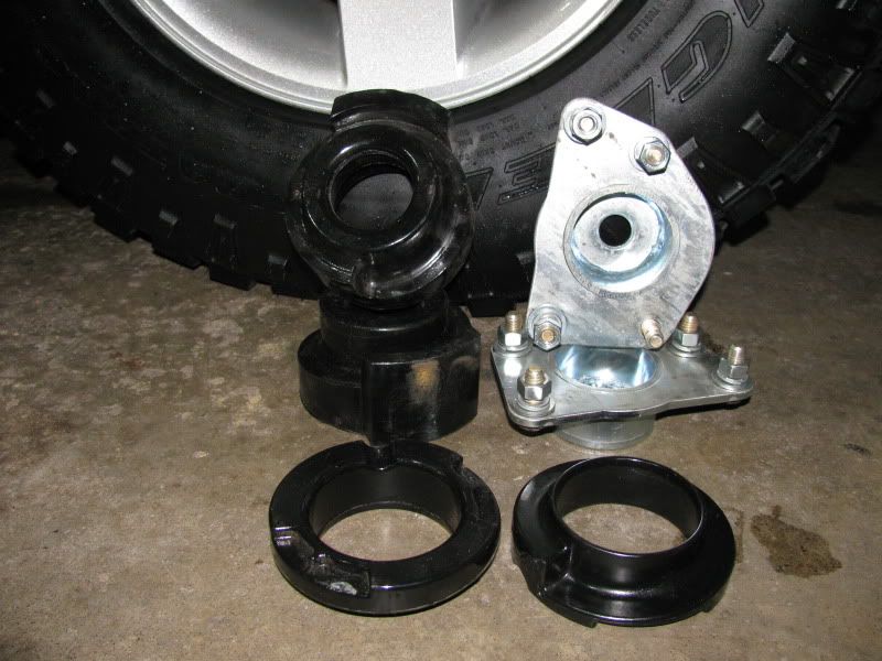

These are the parts for a Frankinlift minus shocks and springs bigger spacer goes on the bottom and smaller on top.
Heres with my OME front springs and Rancho RSX shocks ready to go together, lift number two installed at 125,000 miles Darn first OME Lift only lasted 100,000 before I took it off :ROTFL:

Thanks for that info Jayme didnt know that
Tomm great pic's
Also was trying to clarify if those black spacers(like in your first pic) in the frankenlift are made out of steel
Reason I'm asking is because if the frankie spacers are steel wouldnt u get a better ride (maybe less road vibration) with a diy frankenlift with the poly spacers?

No steel all spacers are poly
No rough ride
Same as Daystar material wise
 Post subject: Re: Franken lift vs. DIY frankie/faken-lift
PostPosted: Fri Jan 06, 2012 11:57 pm
Yes thats what they are, just different thickness
