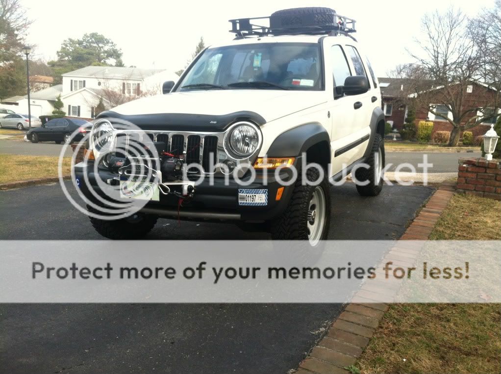

Posts: 90
Location: Long Island, NY
THE BACKBONE system is amazing i have it on mine and ZERO complaints
easy install super great design
2006 kj 6spd white
skyjacker platinum lift with Conduit Clevis lift,
JBA 4.5 UCA
JBA shaved dow CV's
Detours Backbone Bumper System,
Smittybilt 8000lb synthetic line winch, surco roof rack
Cragar Soft 8 Silver Wheels
4.10 gears, 245/75/16 Wrangler Authority A/T
Pinch welds annihilated
Class III rear hitch
HOPEFULLY adding a snorkel soon
