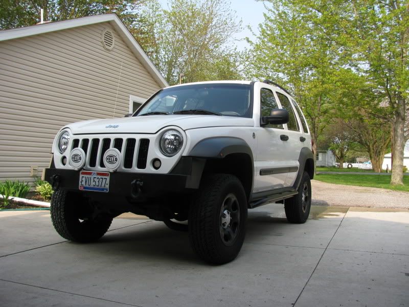

heres are some I have lifted and also BugginKJs with 245-70-16s and OME 927s top plate and clevis on them
opelboys with 235-70-16s right after lift
Buggins
potes again 245-70-16s
silver one is renegademarines 245-70-16 stock wheels

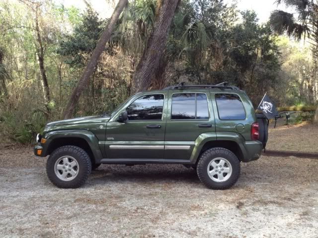

you've had plenty of response already but I'll chime in anyway. I'm running an OME lift with 245/75s on MOABs with no problems. The bump stop advice is good, I bottomed my wheels out a couple times before I got them. I ended up doing the hockey puck thing in the back.
04 Silver Subaru Forester 2.5XT turbo (300+ AWHP)
02 Green Jeep Liberty Limited (OME lift, with MOABs)
Liberty pic --> http://www.sixthsphere.com/storage2/ima ... mlff6d.jpg
