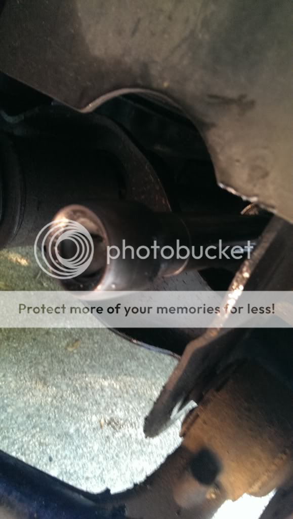

This is my first attempt to post pictures so I hope it works. I have no idea how this happened but I was backing out of the driveway yesterday morning and this happened. I don't know if my wife hit something the night before.
Could someone who has seen this before help me out? Do I need to replace the whole rack? I couldn't find anyone who has had this problem through searches.

looks like the inner tie rod pulled apart out of its socket. Just picked up a new moog tie rod. Im gonna try to do this one myself.

Get both inners and new outers also.Don't forget you will need a alignment and expect the worst that the rack maybe FUBAR'd.

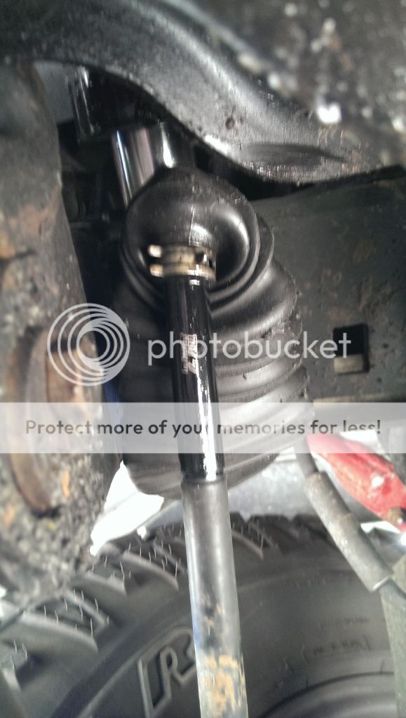

I got the outer off fine here is whats left of the inner. I tried getting an adjustable wrench in there and just cant get it. I even bought the Harbor freight tool that was 50 buck to do this and it doesn't fit over the cup. I did turn the steering wheel to full lock trying to get enough room but this thing is really on there and I cant get a good grip on it.
Any tricks?

If one side did it the otherside will to,yep you bought cheap parts and best to change them all out ASAP.
Try and find one of these..................
http://www.sears.com/shc/s/p_10153_12605_SPM7786623511P?ci_src=184425893&ci_sku=SPM7786623511&sid=IDx20130125xMPAUTx002
Can be found at pep boy's,autozone,and the like also and works.

That 3/8" square drive is needed to loosen the inner tie rod end and tighten it.You clamp it on the inner tie rod end and insert a 3/8" drive breaker bar(and extension if needed),loosen the tie rod end and remove the tool,then unscrew the tie rod end.
