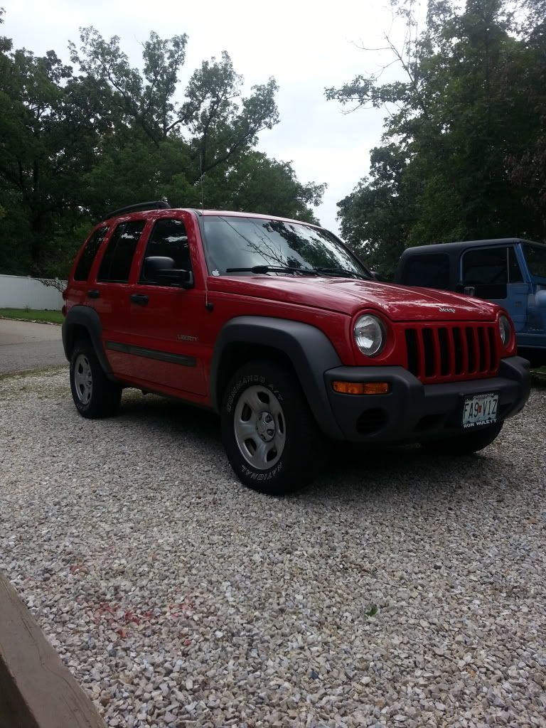

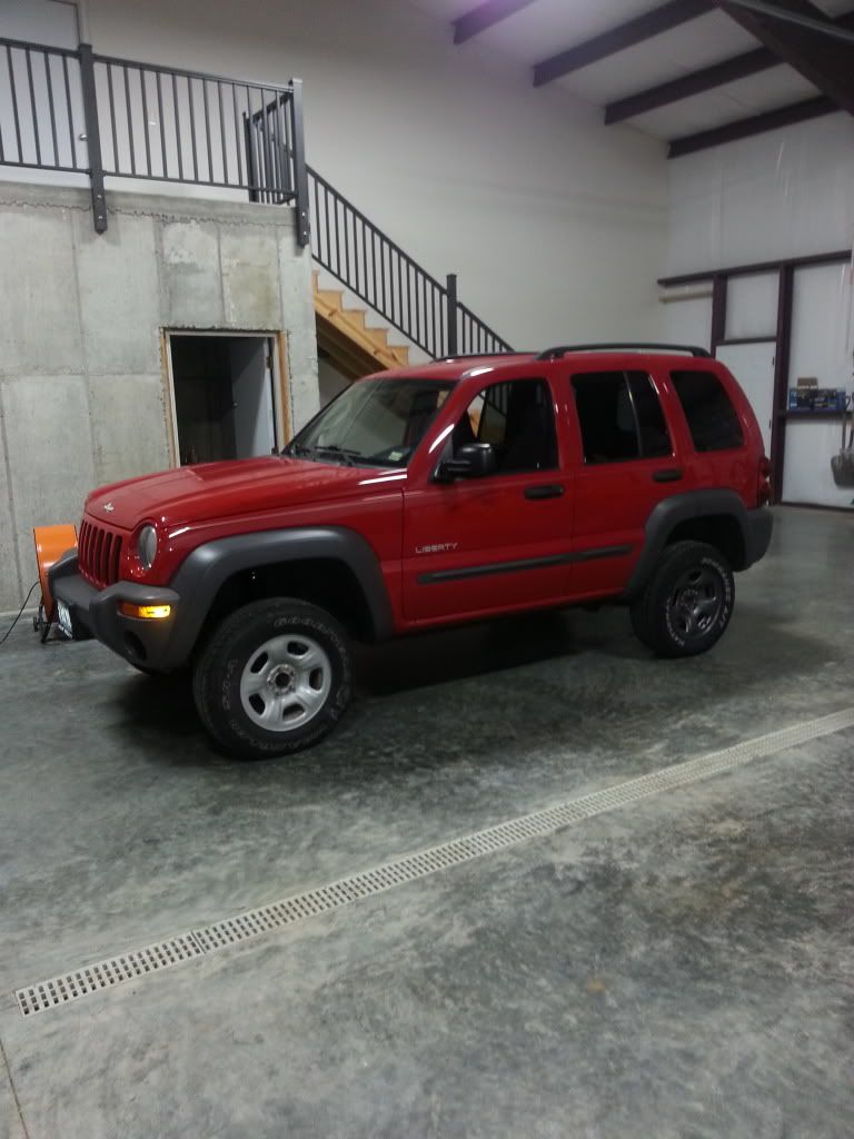

A few shots from the lift.
Before shot.
Back installed
Everything together with the original tires still on.
All finished up.
New meats. 245/75 r16 Bigfoot AT.
Pinch welds pounded. Just to get it out of the way.
Thanks to all of the great info on this site, everything went together with ease.
