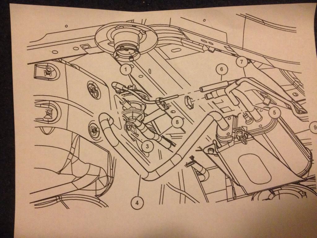

There's also a little rubber hose back by the fuel tank that cracks.

I have tried the gas cap and that wasnt the problem... As far as the hose near the tank that cracks... is this one of the hoses going to the emissiions pump up and behind the tank or another one?

Yep, goes to the emissions stuff.
From a post on another Kj board: #4 fixed his P0442 (cracked at the end)
That is what caused mine, and the oxygen sensors. I also started using 89 unleaded fuel and never came back.
