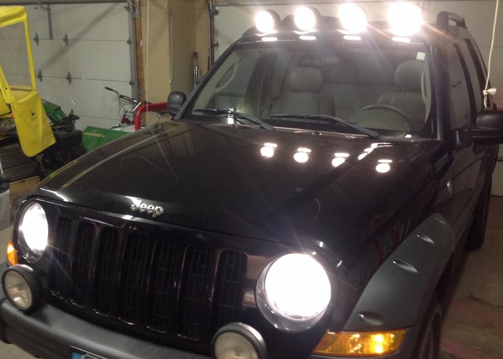

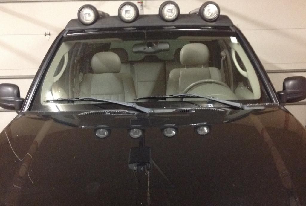

Surprise, my switch does work... so, finally installed light bar with OEM switch today. Everything works! Seems as though I am four years behind the rest of you, but if anyone has any related questions? - fire away. I will never know more about the installation of the "factory" light bar than I do right now.
I decided to wire using high beam circuit. I turn headlights on, turn on brights, and then hit the OEM switch. Switch is momentary... has one function and that is to turn light bar on. Dim the head lights and the light bar turns off. I like it!
2005 Liberty Renegade.

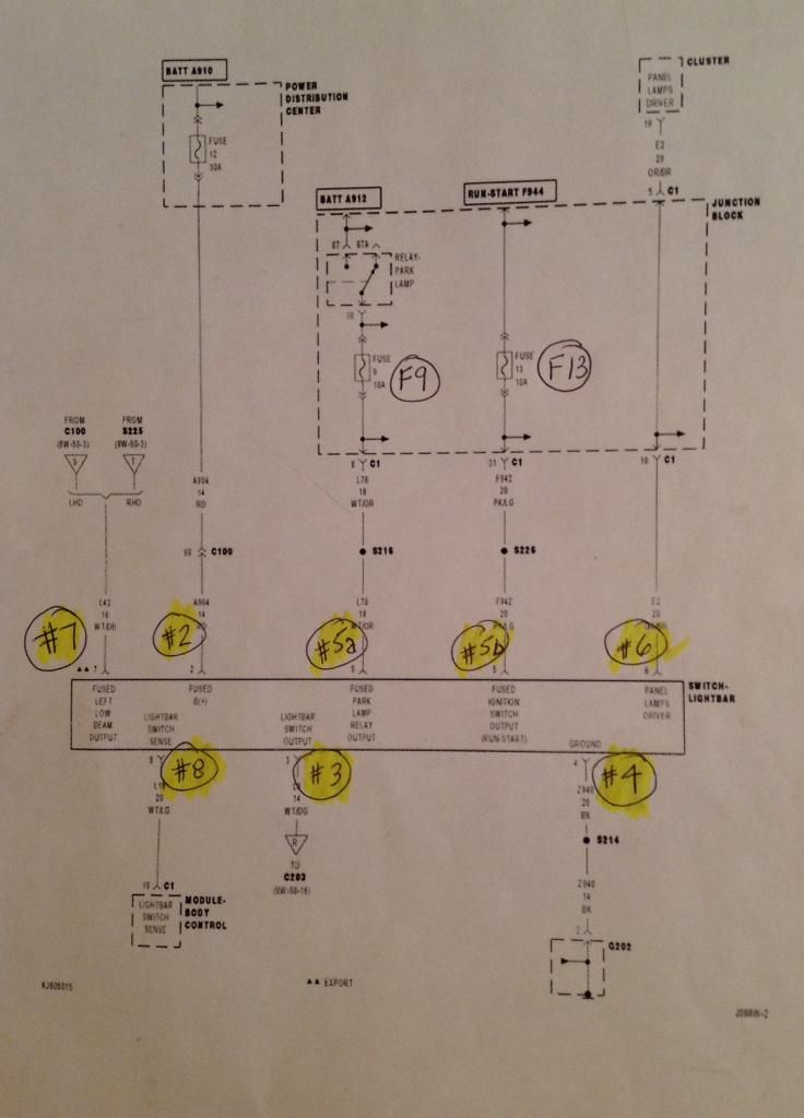

Lessons learned:
Couldn't make sense of OEM switch configuration, then realized every pin diagram was for the switch connector not the switch itself... actual switch pins are flipped but mirrored vertically.
Received the following OEM switch diagram from local Jeep dealer:
Made up my own overall wiring diagram for all the circuits/connections:
