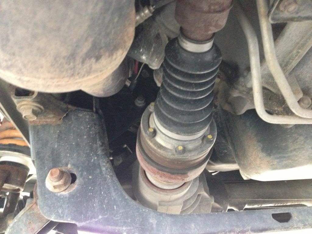

I assume this is what I am looking for? How do I tell if it needs replaced? The black boot seems all there.
Is this what I'm looking for? And if so what should I look at to see if it is the cause? I've read to check if the black boot is ripped. Image

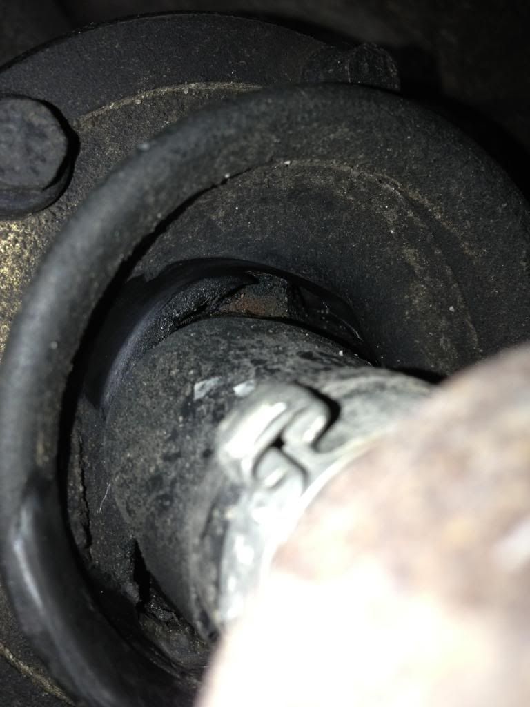

Check other end at transfer case

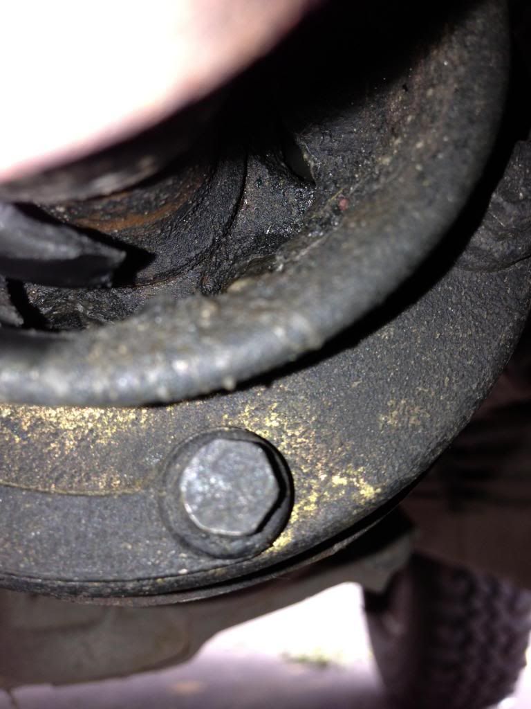

Yikes!
Safe to say I found the issue lol time to search how-to's
