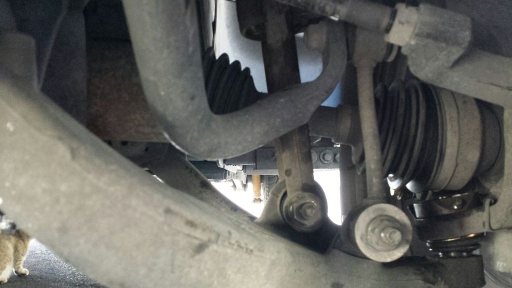

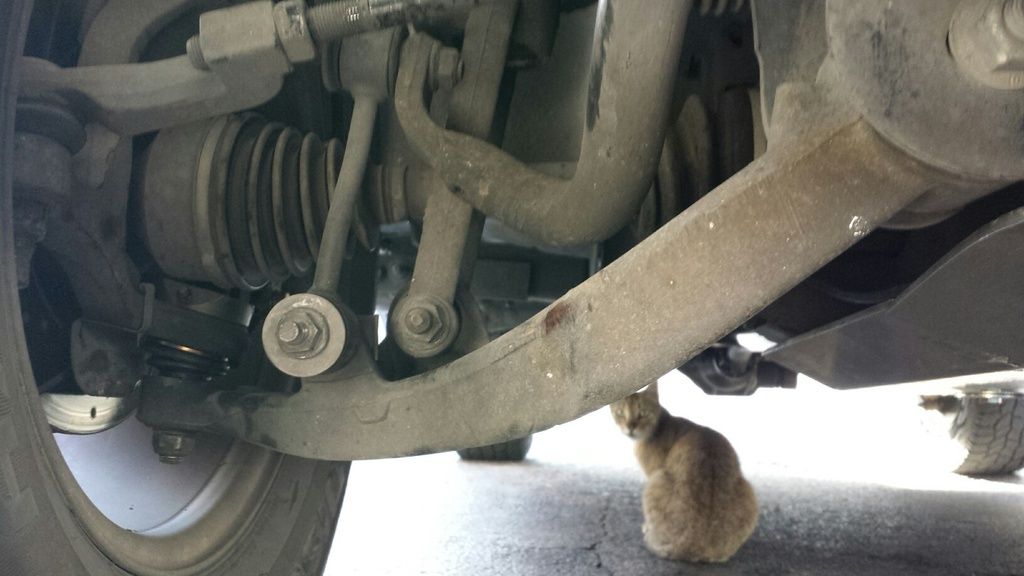

Not on completely level ground Drivers Side CVJoint
Passenger Side CVJoint

Thanks Darby,
I see you have an inspector under there checking things out for you :wink:
