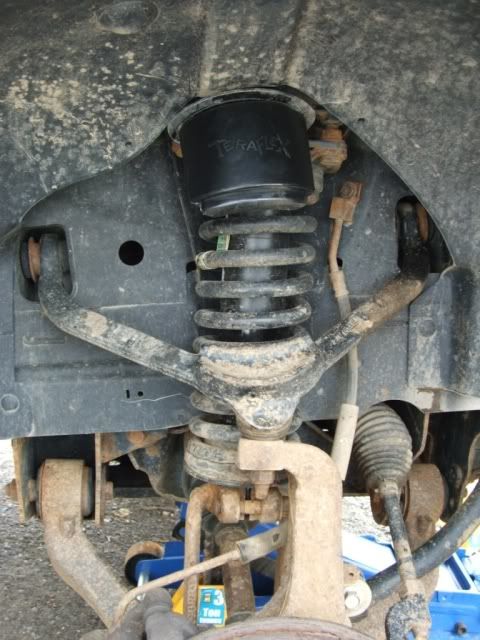

I have the Teraflex lift which is the same style as Rusty's (from the sounds of it). Its been on there 3 years/35,000km on stock springs and shocks. Can't complain.
I did find I couldn't adjust the camber enough after the lift, but aftermarket upper control arms got it back into alignment range.
Hers: 2005 KJ, V6/6spd/NV242J/3.73/posi, 2" Teraflex, ¾" cradle drop, KK forks, 22½" hub-to-flare, RRO arms, 245/75R16s, 260,000km
