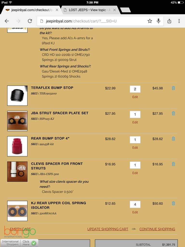

My CRD with some recent upgrades:
OME Struts/Shocks/Springs (already had installed)
Added 3 conduit nuts to the clevis and two top spring isolators to the rear
JBA UCAs added to the front plus Mr. Gasket wheel spacers for clearance
New Cooper STT PRO 245/75/16
New setup measures 36" front and 37" rear from the ground to the bottom edge of the fender plastic.
Happy with amount of lift. Already had the OME setup so take that price and add about $450 in parts and $925 for tires...maybe $200 in labor if you can't do it yourself. $1600.00 plus OME. Way under $4K and completely happy.
