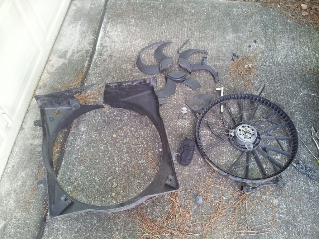

Recently, I started hearing a louder engine/fan/? noise independent of engine speed when it's on.
Shortly after that, I observe the air conditioning works well only when moving, otherwise it just blows hot air.
Maybe the a/c fan in the engine bay isn't working? Any ideas?

Yup.
One or both of your cooling fans is not working.

Thanks. I just popped the hood and took off the cooling fan shroud. I saw the thin plastic condenser fan had broken off and split into 4 big pieces and several small ones. The fan motor does still work though. The shroud also had a 4" x 4" chunk taken off too. The shroud was tough to take out. It was about 2mm too deep to get past the engine fan. I had to twist the shroud a bit to get it out.
Now I need to shop for the shroud and fan blades and see if they are cheaper than getting the whole assembly.
My KJ has the factory towing package which I assume includes the heavy duty cooling.
Some sites like partsgeek list an A/C Condenser Fan Assembly and an Auxiliary Fan Assembly Dornan Dorman 621-017 as the same thing, but I have not seen just the blades yet.

I could find the shroud and motor separately but not the fan blades, so I ended up ordering the whole assembly. I'll keep the old working fan motor in case the new one dies in another 10 years.
I don't look forward to having to twist and force to get the new shroud in. I'm disappointed that the old shroud was 2-3 mm too deep to clear the engine fan. I'll either twist and bend the new one if needed or trim it to make it fit.
Just trim about 3/4 of an inch off the bottom of the shroud just slightly wider than the mechanical fan. It's a common mod done to eliminate the need to remove the mechanical fan and clutch from the water pump every time you want to take out the shroud. You'll be able to slip the shroud passed the fan and into the slots at the bottom where the shroud tabs fit. Should be no more than a 15 minute install once you've trimmed the bottom of the shroud.

Trimming that 8" wide x 3/4" deep section at the bottom of the shroud made placement a very quick and easy thing.
The A/C works great again now at idle and when moving.
