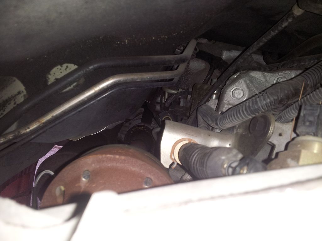

It attaches on this post - just snaps on.

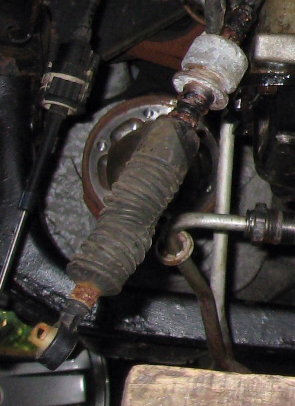

And the end that snaps on there looks like this

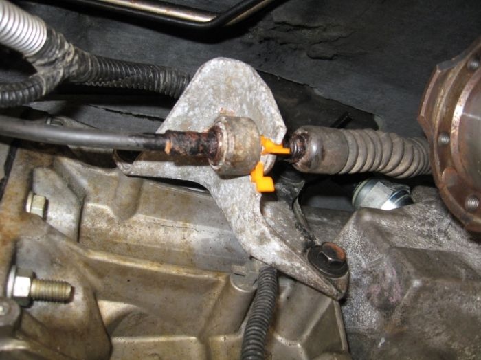

Driver's side towards the rear.
Nope, no need to remove the decorative rock rails; mine were in place for the photo.
Here the cable's in place. You can see the switch from the above photo and rear driveshaft connection. Slide behind the driveshaft and look.
