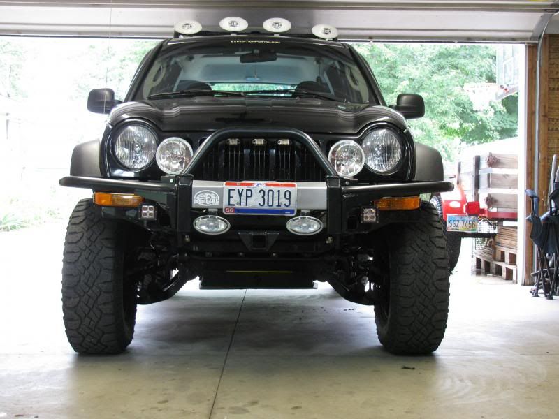

Plenty of ground clearance I think :wink:
But seriously lift it , build it right and you'll love it :lol:

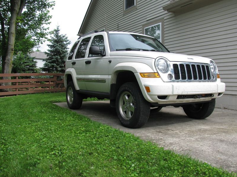

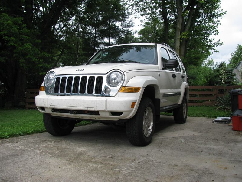

Here is the last CRD that I lifted for a customer from Kentucky
Before and after shots ( Full OME 790/948 kit with clevis lift/ top plate and jeepinbyal UCAs )
