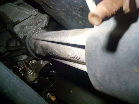

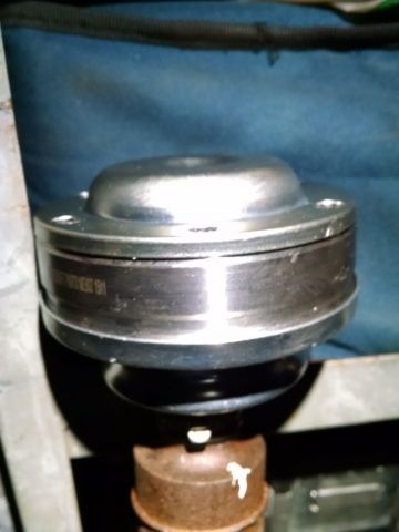

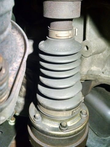

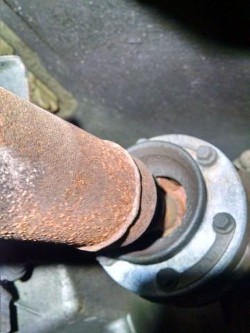

Ok so I got under the jeep again and looked at all the cv and driveshaft boots, they all look good to me I tried to wiggle them and they are tight for a vehicle with 208k miles used mostly on 2wd except for a few miles once in a blue moon when I get on wet snow. I attached a few pictures for You guys to look at maybe I'm missing something obvious to someone else.
One thing I'm not sure about, when the TC is in 2wd and the vehicle is parked, if I try to turn the front driveshaft is it supposed to be tight or turn? I only know fords the NP205 for example, will allow the front driveshaft to turn freely when on 2wd but this jeep TC doesn't allow me to turn it freely when in 2wd and the vehicle parked, does that make sense?
I'm about to take the TC apart but I'd like to have a text that will guide me a little, My wife drives this one and I don't want to put it down unnecessarily. Thanks in advance to everyone for any help.
How do I attach pictures on this forum?

Your last photo shows the rubber boot on the rear cv of your front driveshaft is gone. (Transfer case end) The innards of the cv are exposed to grit and grime and have become rusty - you shouldn't be able to see into it like that. There should be a rubber boot that holds in a lot of grease there, so 99% sure this is your issue. Don't take apart your transfer case!!!
Here is the how to thread for fixing it for about $55. (Just did this on my KK last month at 120,000 miles.)
http://www.lostjeeps.com/forum/phpBB3/viewtopic.php?f=16&t=56917

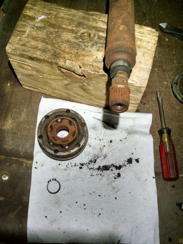

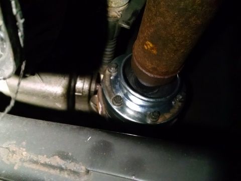

I put in the new bearing and for a little while it sounded as if it was a little stiff or too tight but now it got much better. They have two kit one says Jeep and the other says Liberty but they both work. Here are the pictures I took.
Thanks everyone.
