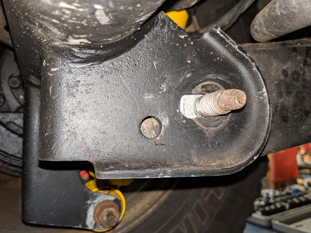

Hi. I got a donor differential for my 2006 CRD. I rebuilt the doner with trutrac LSD and all new internal parts except gears which were in perfect condition. I setup the diff correctly (experienced rebuilder) and swapped them out. I rebuilt the prop shaft with new ujoints (experienced) correctly indexing the parts for balance. One wierd thing is that the new diff has slotted holes for the trailing arms and the previous one only had round holes. This made me suspect the pinion angle ( on a two ujoint system the output and input flange angles must be parallel) They are really close, within measurement error. One thing that did happen is I had to press one ujoint out with lots of force but the replacement fit fine so I don't think I "bent" the horn.
Anyway around 45 I get vibration I didn't have _and_ it seems worse under load. Any suggestions welcome.

Slotted holes? That sounds weird. Does it look pounded out? i.e. from loose bolts? Or intentionally done?
Vibrating harder under load suggests the pinion is already a tad high, and load raises the pinion further.
I would try shifting the diff to the other end of the "holes" (probably lowers pinion) and try another test drive. Its possible your axle came from a lifted KJ where somebody had tried to adjust the pinion angle.
If you find the other position is the cure, you can probably weld some washers over the ovalled holes.

Do you have any pictures of the slotted holes?

PostPosted: Mon Jan 28, 2019 1:00 am
Yes I want to see the slotted holes for one
Plus some other things you have done

Okay so the NVH app showed a 2nd order vibration at 0.36 amplitude. After measuring the drive angles again I added a 5/16ths shim above the transmission mount crossmember to lower the transfer case. Road tested again and measured a 0.06 amplitude 2nd order vibration, wow 84% improvement, not really noticeable in the wheel at 45-55 at all now, I can't tell at least. Gonna add 1/8 more shim tomorrow and post results. I have only installed the OME "lift" kit, no additional plates..... The front measures 4.5 inches of clearance above the 245/70R16 tires, the back 6 inches so the trim height changed allot after this lift.
And finally here is the picture of the slotted holes in the rebuilt differential trailing arm horns?
The picture you shared looks like someone was trying to adjust the pinion angle on a lifted vehicle by grinding those slots in the metal? :shock: :?
If you have a "lifted" Libby and would like to be able to adjust the pinion angle, you can install the IronRock rear upper control arm using a custom mount that I developed for the KJ.
It allows you to adjust the pinion angle as it has a threaded Heim joint as pictured below.
The IronRock Arm was originally designed for the much larger and heavier WJ Cherokee and is super heavy duty and will be the last one you ever purchase for the Liberty.

vwroad87 wrote:
After measuring my front and back from the center of the tires to the flare I have a difference of about 1.5 to 1.75 inches. I'm wondering in order to level this if a .500 clevis shim is correct for this difference? I have installed the OME kit, front and rear.
https://jeepinbyal.com/clevis-spacer-for-front-struts.html
The lift to spacer ratio is 2 to 1 with our IFS such that an added 0.500 inch at the coil over will yield 1.0 inch of lift at the hub. There's really no need to use spacers with a clevis lift, just ensure full contact between the strut fork clamp and the strut cylinder is maintained and torque the clamp to spec. Using this rule and depending on your particular equipment, you may not be able to add 0.500 of space. If the clevis doesn't give you enough, JBA sells 0.25 inch top plates that will give you another half inch of lift. Some like me have also installed a set of slightly longer KK/KA cast strut forks. These three things together are working for me, but I'm on some definitely sagged OE springs. YMMV.
Does leveling this way actually improve your driveline angles?

iakj11 wrote:
Trim height is changed by my lift, this lifted the transfer case too with respect to the differential. By shimming down the transfer case cross member by 5/16 I was able to reduce the vibration 85% by way of the NVH app. I have read online that the .5 inch spacers are not an issue to install? Hum?
There is no issue installing the .5 clevis spacers. Plenty of room for them on Bilstein struts, can't say for sure on other brands.
Even with the .5 spacers on mine with the Bilstein struts, the strut shock tube still sticks out below the clevis about 1/2 inch.

WWDiesel wrote:
Yeah, my Rancho RS5764s don't have nearly that much tube to work with. Their design actually makes clevis spacers a challenge - note the reference bump on the tube and the way the metal plate above is flared.
Time for different suspension!
