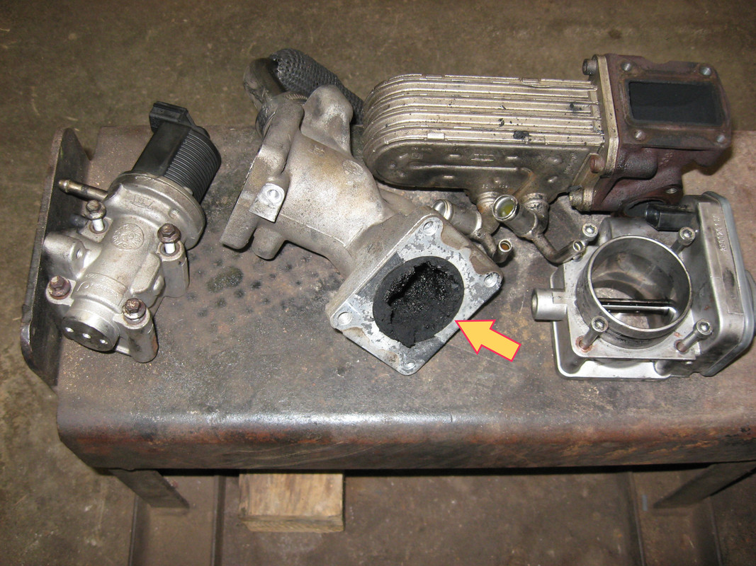

If you can, the very best thing you can do for your motors life is to totally remove or at least block off the EGR system.
(Drawing of EGR block off plate shown below)
They are a known engine killer due to making mud soot pies in the intake manifold and contaminating engine oil (soot loading) along with particle blasting the valve stems. See images below.
