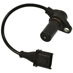

So, the code it is throwing is PO339. 'Crank Shaft position sensor a circuit intermittent '... On my way back from errands today it happened again and I was again on the side of I5... no damsel in distress here... waited another 5 minutes and I was off and running!

Replace the crank sensor or have it replaced. They are notorious for going bad and putting you on the side of the road until they cool off a bit.
Mine put me on the side of the road twice with no codes set before I replaced it.
Autozone has a re boxed OEM Bosch sensor Duralast (Bosch part in box) Part Number: SU8492 for a decent price.
They can be changed from underneath the vehicle, plenty of info on this forum as to how to.

This is what you will be changing:
On right side of engine from underneath, remove the heat shield, then disconnect the Crankshaft Sensor connector, then remove the allen head bolt on the sensor itself.
Once you remove the allen head hold down bolt, simply twist the sensor back and forth while pulling on it and it should pop right out.
NOTE: It can be done without dropping exhaust pipe.
Install is simply reverse of removal.

I've been underneath this thing for quite some time now! I cannot figure how to unclip the crankshaft positioning sensor from it's male part! I'm about to lose my mind. Clip started to crumble in my hands... I need to put fresh eyes on it in the morning and find schematics on how the male and female come together... and how in heavens name does the CPS come out of the metal clip it rests in... I'll search here to see what I can find... direction would be greatly appreciated! Thank you all!

Take the bolt out of the metal clip and let the whole wiring harness drop down with the CPS after you get the sensor removed from out of the block.
The clip is only holding the CPS connector for the sensor. The sensor is in the side of the block.
See the picture I posted, it shows it clearly.

So... the piece that will not come apart is the male end that comes from the wiring harness... I'll try to figure out how to post a pic of what I mean

Some of these type of connectors on this vehicle have a little red locking device on the connector that must be pulled out about 1/8 to 1/4 of an inch first before the connector will release the male from the female part of the connector and allow them to be pulled apart.

IT'S ALIVE!!!! :pepper: All set fellas! It was a little trying but I did it... now... problem 2... while Agnus was up on ramps with the e-brake on... the right rear caliper froze... or something... I've know for a bit that it (or rotors) has been warped... but evidently something went wonky while in the ramp position... so, next step... rear calipers, rotors and pads... I'll see you on another topic!
