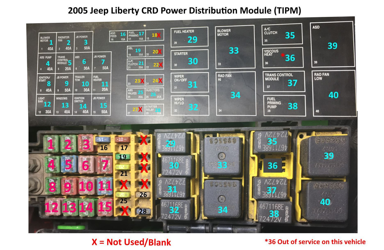

Posts: 7390
Maybe these wiring diagrams and picture of an actual 05 Power Distribution Panel will help you understand how the Jeep CRD is wired for the in-tank fuel pump from the factory? Keep in mind, the WD's are adapted from the gas Liberty since the CRD FSM WD's do not actually show the wiring as installed in the vehicle for the Fuel Priming Pump.
Fuse for pump is no. 17
Relay for pump is no. 38

Location: Alaska
Yup, relay #38 and #19 is where the wire was crudely stuffed with the relay plugged back in. I read #5 off the relay itself since I couldn't squint hard enough to read the numbers on the socket side.
My parts jeep is an '05.
