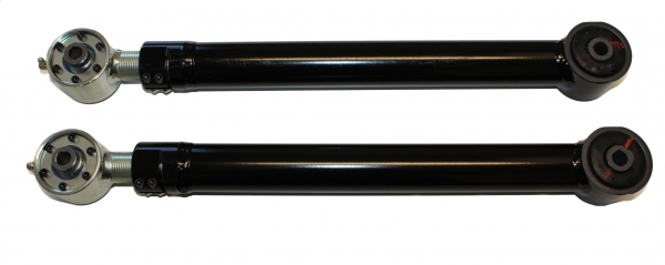

May be able to adapt or modify some of the HD IronRock adjustable Control Arms to the fit the Liberty?
Like these:

The stock KJ rear lower control arm has a length of 17.32 inches (440mm) I would guess that there would be a drop in fit control arm from another make/model of Jeep.
Some options I have found so far:
CB Engineering, based out of Iowa, actually for KJ
https://cb-engineer.com/products/2002-2007-jeep-liberty-kj-heavy-duty-adjustable-rear-lower-control-arms
From Iron Rock Offroad, for a WJ that is adjustable from 15 3/4" to 19 3/8. Need to verify the bolt diameter and bushing width is the same as the Liberty.
https://www.ironrockoffroad.com/product/wj-heavy-duty-adjustable-lower-control-arms.html

I measured a stock control arm bushing, it uses a M14 through hole and the bushings are 66.4mm wide. This is for both the body and axle mount.
Looking at Iron Rock's website this would the M14 x 2 5/8 inch size joint.
Phil
So looks like they fit?

Yes, according to the measurements they will fit.
I ordered a set of the Iron Rock adjustable control arms and will show some comparison pictures when the arrive.
