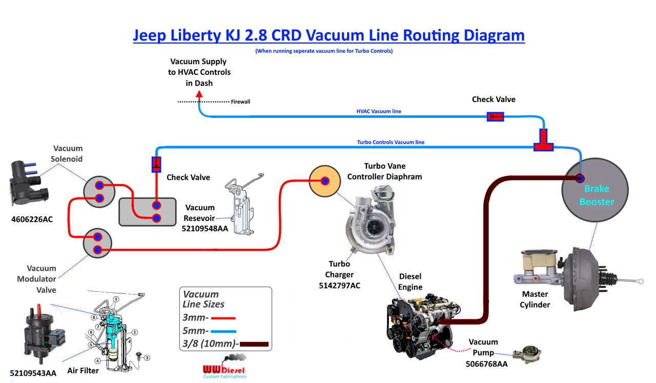

Davide33 wrote:
No Codes. It seems to be running great now. I did notice that since I replaced some vacuum lines, The thump I'd been hearing from the dash on startup is gone.
When I replaced all my vacuum lines, I used silicone hoses which are impervious to heat, cracking, and collapsing.
FLEX TECH SILICONE HOSES & TUBES
I found some of the OEM tubing cracked and heat had cause one of them to be partly flattened out and kind of crimped.
I also split the vacuum system at the brake booster source and ran separate hoses one for the turbo controls and another one for the HVAC system.
This upgrade also improved turbo responsiveness.
See this:
