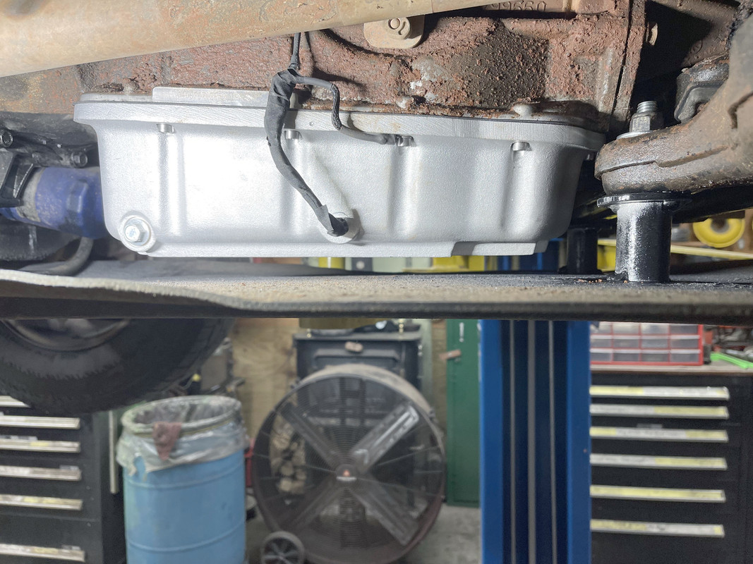

FYI, GlowShift makes some real nice gauges and their prices are not to bad. I have several of them and love'em. see picture 1 below.
There are some aftermarket pans available for the 545RFE transmission that already are taped and threaded for a temperature sensor and a drain plug. see picture 2 below.
Some of the aftermarket pans also increase fluid capacity and have cooling fins which helps greatly to improve fluid cooling and promote lower operating temperatures. If you want more info, let me know.

fjdiesel wrote:
I like the look of those Glowshift gauges. I will check them out.
How much does that pan hang down? That looks like a perfect solution. Did you have the gauge before the pan? Just wondering how much of a difference you saw.
Deep sump oil pan added a little bit over 2 inches lower than stock OEM pan. I dropped my home engineered skid pan 3 inches to provide clearance.
And yes, I had a gauge before adding the deep sump oil pan. Was getting temperature measurement from a "TEE" block I installed in the fluid cooling line going to the fluid cooler up front. By adding the deep sump oil pan it allowed me to order a second temperatuer sensor and put it in the PML pan. I then added a SPDT switch which allows me to switch between the two different sensors/locations and compare temperatueres.
So far in our hot high humitidy South where I have seen some high 90's with humidity above 90%, the transmission fluid temperature has been 30-40 degrees cooler than before deep sump oil pan addition. Keep in mind, with the deep sump oil pan, it required an additional 5 qts. of ATF+4 to get the level up above the full mark.

fjdiesel wrote:
Thanks! I like the look of that pan. I see on the PML website they are out of stock for a month.. I will get one on order and do it then. Thanks.
Check with Geno's Garage, that is were I bought mine and got free shipping (may have been a special) and a great price. Shows as IN Stock.
https://www.genosgarage.com/product/PML ... ssion-pans
TRANSMISSION PAN - PML - EXTRA DEEP ('07.5-'12, 6.7L - 68RFE)
Item #: PML11039
Also fits 45 & 545RFE transmissions.
Be sure and replace both filters while you have the pan off. :D
