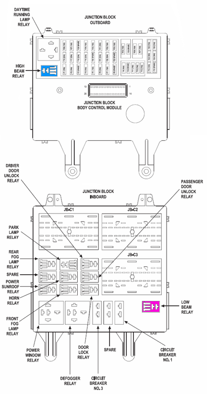

Certainly could be the mulit-function switch, but it could also be a bad low beam headlight relay.
The high and low beam headlight relays are controlled by the multi-function switch through the Body Control Module.
The low beam relay is located in the junction box fuse panel on the left side of the dash.
I would swap out the high beam headlight relay with the low beam headlight relay and see if that fixes your problem before changing out the multi-function switch.

If you look at the FSM (factory service manual), you will see that most of the major lights on the Jeep CRD are controlled through the Body Control Module.
Index of /manuals/Jeep/KJ
2005JeepKJServiceManual.pdf
The multi-function switch simply tells the body control module what light to activate.
You can test the low beam headlight circuit by simply removing the low beam relay from the fuse panel and jumper pins 87 to 30, doing this should make the low beam headlights come on regardless of what position you have the stalk switch in. (See relay drawing below)
If they do not come on when doing this test, then the problem is in the wiring between the relay and the headlamps.
If they come on OK, then your problem is in the multi-function stalk switch or the wiring to / from the multi-function switch or worse yet, the Body Control Module.
