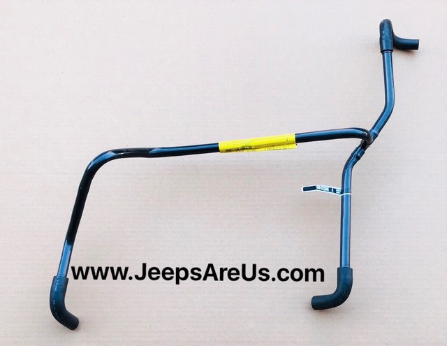

I bought a used engine to swap out on my 04. It came with a box of parts which I puzzled back together . But this was left over! Lol. It looks like a vent tube for crank case ? I hooked up other tubes to crank case and other parts . Image
Either I put the other tubes in wrong or this part doesn’t even go to my engine? I tried looking for a diagram for vent/vacuum lines on the web but nothing good.
Thanks for any help.

CRD or gas ?

4 or 6 cyl?

It’s a 6 cylinder gas 3.7

Could this be it?
53013723AC :google:
Engine Crankcase Breather Hose-fits 2005 Jeep Liberty 3.7L-V6
Mopar Wholesale Parts .com
https://www.moparwholesaleparts.com/oem ... 53013723ac

Yeah that is it but I can’t figure out how it fits on the engine. Ha! Shoot. Every vent port is taken up with another vent tube already.
