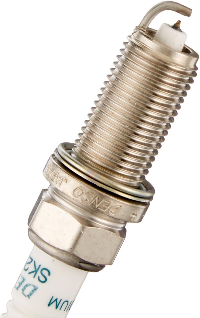

Champion are crap but it’s what most Chrysler products take, you can use big or denso if you want, I usually replace them at work with some denso long life iridium since most people don’t do spark plugs on time so it give me a little fudge room… it’s amazing how many people look at it as an oil change interval and not a service interval so they get cheap oil changes and then by the time I see it it’s a how mess… if there is more than 20k on the clock here is always more services that are due

Denso long life HD Iridium spark plugs are super good spark plugs, they "Rock"! Cost a little more up front, but worth every penny. :D
I have installed them in every spark infested engine I own except my old Farmall Tractor. V8s down to chain saws!
They actually even have them for small engines like lawn mowers, chain saws, pressure washers, portable generator engines, etc...
Basically, install them and forget them for a very long time. :rockon:
