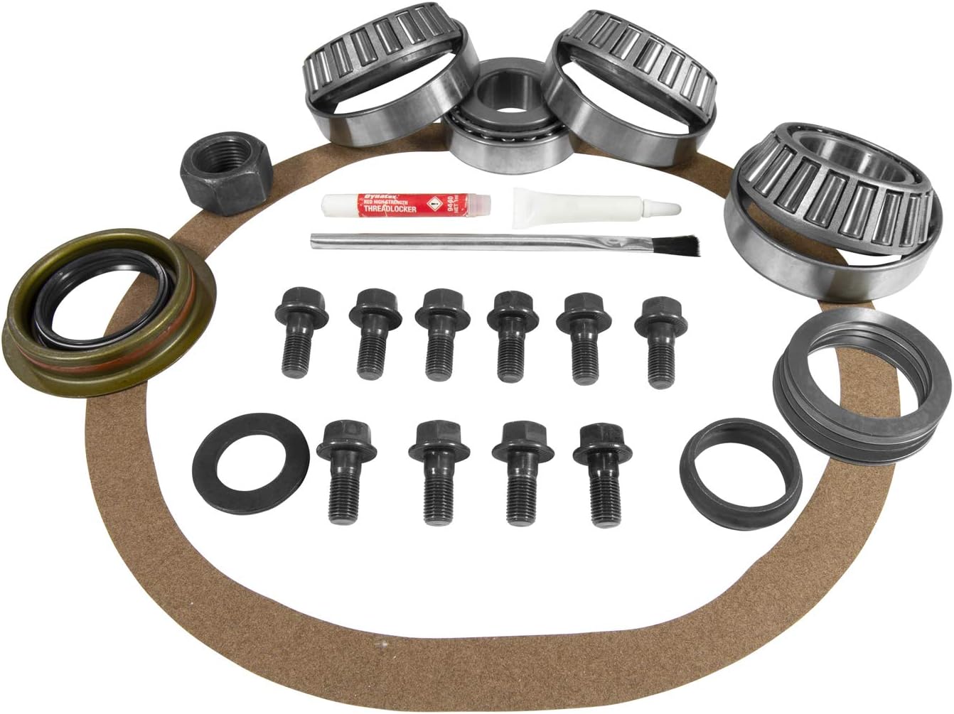

What else in the installation kit?
 Post subject: Re: I've broken my diff
PostPosted: Mon Mar 06, 2023 5:17 pm
Posts: 7379
juriola wrote:
Thank you for the response!
well 25$ reusable gasket against 5$ one use. I will think about it :)
Bearings, shims, new crush sleeve, bolts, contact pattern paint, etc...
USA Standard Gear (ZK C8.25-B) Master Overhaul Kit for Chrysler 8.25 Differential
https://www.amazon.com/USA-Standard-Gea ... 8OZS&psc=1
