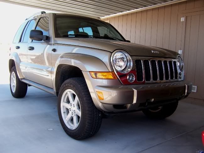

Frankenlift II Premium, OME HD coils and struts/shocks all around, Al's A-arms, 245/75-16 MT/Rs on Moabs. AllJ did the install, they did some pich weld pounding and front bumper/air dam trimming. There doesn't seem to be any danger of rubbing on the pinch weld, but there is still a teeny bit of rubbing on the front bumper under specific conditions.
Here's a before and after so you can see what kind of trimming the air dam required:
Wife and I are both very pleased with the results.
