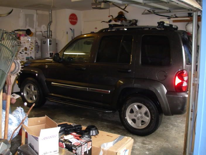

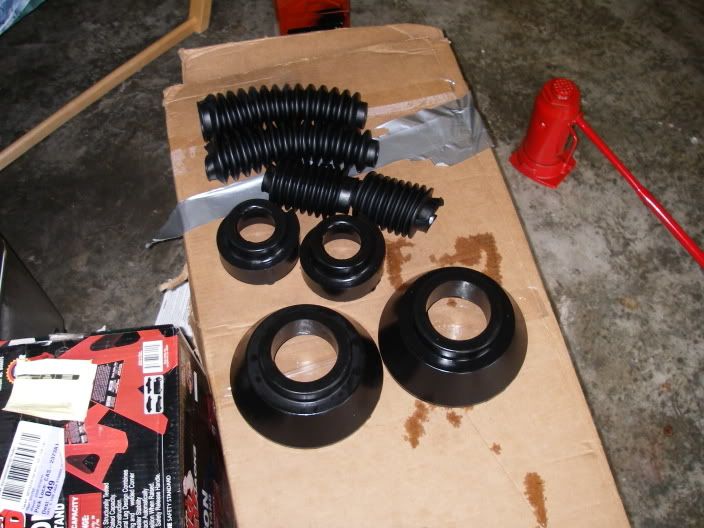

Here are the parts
Jeep in the garage - pre-lift

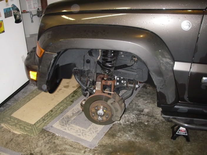

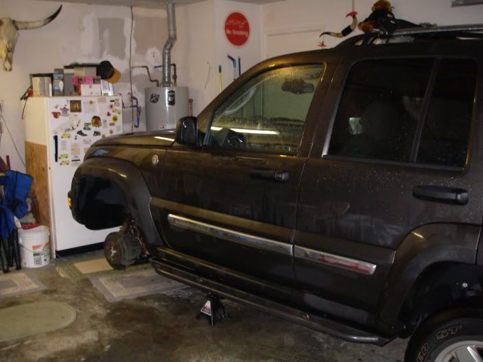

First wheel off - view one
First wheel off - view two

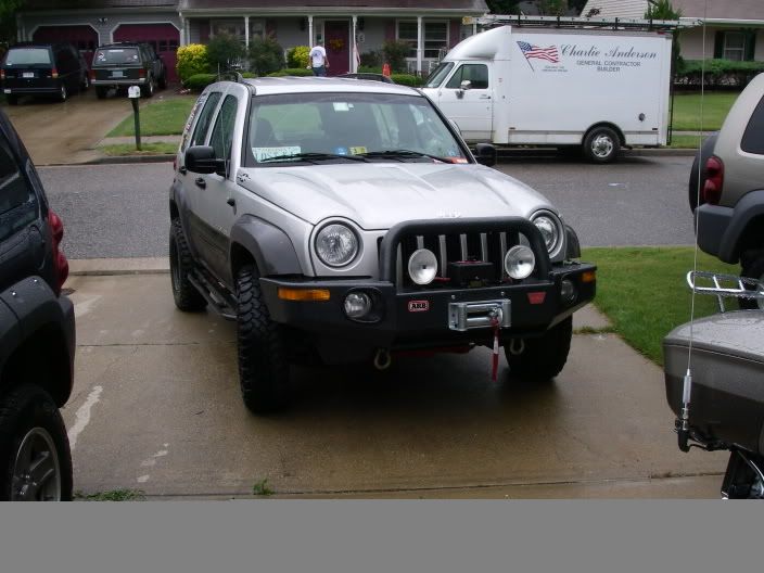

Richard's new winch
Four KJs in Ugg's driveway

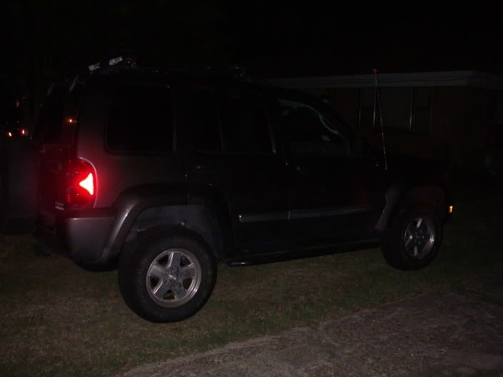

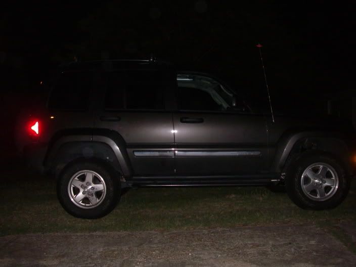

And this is the Jeep post lift.
I've only taken picts of it at night since the lift, so that's all I have to post for now. I'll get some picts in the daytime later.

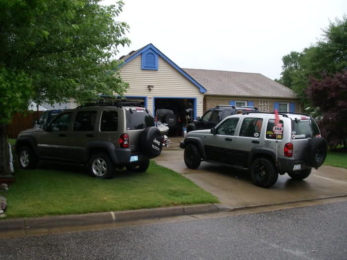

I don't know why, but the pic of the Libertys filling your front yard made me laugh. Nothing like a group of Jeeps to get the attention of the neighbors. Anyway, from what I can tell from the night pictures, it looks very nice. The color of the KJ is one of my favorites also.

That pict does look like a KJ assault on Ugg's house, doesn't it? Kinda cracks me up too. The neighbor across the street has a green Renegade too. They we're into doing anything with it though. I did catch them staring over at us once with a look like, "What are you doing to those trucks?" on their faces.
