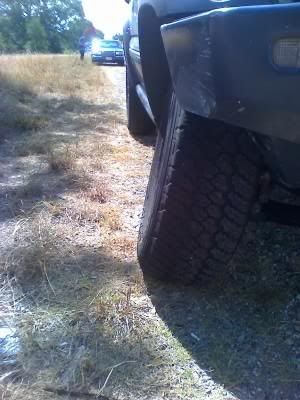

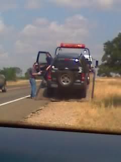

well i was begining my trip home after my week long vacation when 1/2 hour down the road this happens:
snapped the A-arm at the weld around the ball joint at 65 mph!! the seat is clean but now so is my wallet:(

yes it was scary. i have the replacement arms at the shop with the jeep now so tomorrow i should get it back and if that is the case i will begin my 15 hr drive back on thursday morning. it is one thing to have it happen at home and a whole other thing to have it happen 950 miles from home. i am just glad i am not stuck somewhere in west texas hiking down I10 or worse i coulda flipped it but luckily i had a good grip on the wheel when it happened and reacted properly.

so I take it this is the older Al's a-arm? Glad all was well! And Im glad that didnt happen when you started out on vacation!
Starting to see more of these break than the stock arms. :shock:

I take it that they were Als arms? What generation. I bought a used set of the 4s and one of them had cracks in both welds on either side of the ball joint. Other one looked OK but??? I now have a set of the 4.5s and they look better made to me
but then what do I know :twisted:

I've personally broken two older gen Al's arms, both in the same place, front side weld to the ball joint bung, and both on the driver's side arm. I was doing nothing hardcore (coming off a curb 1st time, driving up a little hill 2nd time), but time took it's toll and both breaks showed rust on the inside of the arm around the breakage. They probably had stress fractures that I never noticed. I think Troy is taking me into account with those numbers, but I'm pretty sure this last set I broke was Gen. 3, and the first was Gen 2.
Regardless, they were <Gen 4 for sure. I've heard the Gen. 4s are better and I know personally that the Gen 4.5s look MUCH MUCH better and if they break then the Jeep is gonna get parked until I have the cash for an SFA. New daily driver=motorcycle.

it was JBA. it was the one right before they came out with the gussets and removable ball joint

thanks for all your concern. i have gotten the jeep back from the shop (the mech only charged me 2 hrs labor) and all is good so i should be on my way home thursday morning.
