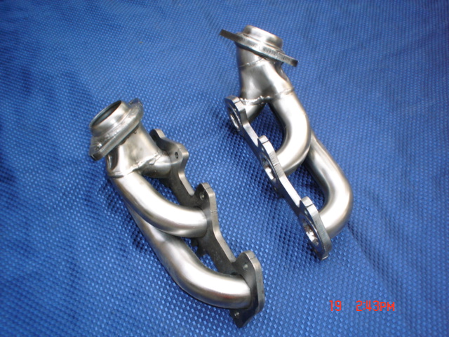

 Post subject: were these what you had?
PostPosted: Mon Jan 22, 2007 2:03 pm
Joined: Wed Oct 26, 2005 10:57 pm
Posts: 193
Location: Columbia, MD
Image[/img]
03 Liberty - Borla
2000 Dak Quad Cab - 31 Mich ATs
PostPosted: Mon Jan 22, 2007 2:52 pm
Posts: 1195
That looks like the ones that wouldn't fit my 2001. They bolt to the collectors with 2 bolts instead of using a clamp and a single bolt?
June 2001 Liberty Limited 4X4
PostPosted: Fri Jan 26, 2007 3:54 pm
Joined: Sat Oct 14, 2006 5:03 am
Posts: 337
Location: grafton, ohio
To tell you the truth, by looking at the piture, I can't see them doing very much. Puy jba's on the ranger, made 0 hp improvement and lost torque under 3000 rpm's. For the price, I sure got handled. Like on a ranger, I believe long tube headers would be the way to go for any real benifit other than lighting one's wallet. The kj's exhaust manifolds would have to be very restrictive for those to help. For us offroad guy's it may hurt more than help if they cost us lowend torque. I got burnt on the jba's for my ranger, so now I'm a little skeptical about shortie headers on an offroad vehicle. They did help alittle on the topend, but I'm not in that range enough to justify 500.00 bucks and it cost me on the lowend where I do operate the most offroad. I'ld like to see some real numbers on these.
