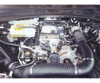

Ok so i got my lift and tires on now i am obsessed with a forced induction set up on my kj. I've searched the internet and apparently no one makes a supercharger kit for the libby. I've looked over a few dakota forums and they are interested in one too. It's said that it maybe possible to use one from a 4.7 but i haven't found any info to confirm it. I emailed Kenne Bell and here is what they told me.
Hello,
What are the chances of you guys bringing back the 3.7L supercharger for liberties and dakotas? I feel there should be alot more demand for them now since this motor has been out for a few years. Do you have any of these left laying around? I am seriously interested
thanks
Jeff
We do not have a kit for the 3.7 liberty anymore, sorry.

PostPosted: Wed Jun 06, 2007 3:05 pm
They don't make the kit anymore because the top piston rings on our engines are to close to the top of the piston which leads to all sorts of problems(broken pistons) when forced induction is used.They have the warning for the 4.7 guy's to since they use the same pistons in the 4.7 as the 3.7.You would have to rebuild the engine with different pistons to live with a supercharger or turbo.

PostPosted: Wed Jun 06, 2007 6:11 pm
myjeepwalks wrote:
Yeah i read that somewhere, but if the 4.7's have the same pistons as the 3.7's what's the difference. I can't see why they wouldn't make a kit for the 3.7 if the 4.7 has the same issues. As long as you didn't get nuts with the boost i think it'd be fine. I cant find much info on that kenne bell s/c. Did they make only one or are there other people out there with them before the kit was discontinued? :?
If I remember right they only make one kit(the prototype) and scraped it after it broke the pistons.Just remember that the 4.7 has 8 cylinders to spread the boost to not six,it will live longer than the 3.7 will even at low boost.Anything under 5psi boost is a waste of time and money anyways(only like 30hp).
PostPosted: Wed Jun 06, 2007 8:13 pm
Posts: 1195
The longer stroke of the 3.7, and more boost per cylinder makes the problem worse. The 4.7's still have the problem if they don't have upgraded pistons and rods, just a little more forgiving. The 3.7 could fairly easily be built for a supercharger, and if you have the 45rfe you just need an upgraded torque converter and reprogramming kit to make the transmission handle it. I discussed using a Paxton kit for the 4.7 thouroughly with KRC a while back. To do it reliably, you're going to want injectors, cams, pistons, rods, ported heads, headers, and programming in addition to the kit.
After doing more research; compression is higher in the 3.7's like 9.6:1 compared to 9.0:1 or something in 4.7. I already got the 45rfe with the programming kit. Think i'm gonna ditch this idea because my kj is my daily driver and dont need to be screwing it up. Should of bought a TRD Tacoma they've got all kinds of stinky poo available. :x

Yes, the compression is higher in the 3.7. That's one of the reasons you need custom pistons.
You need 4.10 gears. They'll help get your power back from those heavy tires. A B&G flash, and a Fastman throttle body would help also. Get some cold air to your K&N, and this combination with an exhaust will really wake it up.

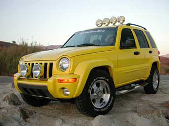

Does anybody know what happened to that yellow patriot liberty. Was it sold or destroyed? Did anyone ever buy one of those kenne bell kits for the 3.7 or was it just a prototype for that liberty?
02' Sport- SOLD
Yeah it's got a hemi!
PostPosted: Tue Jun 26, 2007 12:27 am
Posts: 484
Location: AZ
I think it was just a prototype. They never went into full production for it because of the issues described earlier.
