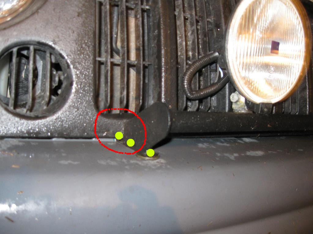

Here are my pics for now, Ill get my other camera today maybe and snap a few better resolutions ones. All in all, quite happy. No more wobble with my Hella fogs and I have a platform to add some more. Wooohoo! What are your plans dude?

Looks good. Is that 4 bolts to mount it on there?

6, two under the grill, I had to notch it a little bit to get the fit I wanted. Took about an inch off the bars mounting plate.
The area circled was notched to slide it under the grill a bit. Third hole was drilled close to the back one to facilitate another bolt. I put green dots where the bolts are.
