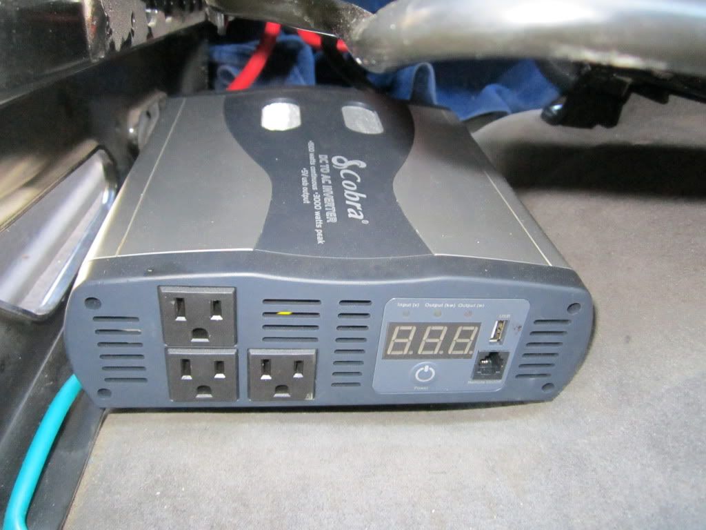

I have a 1500 watt one installed under the passenger seat. Works really well. I needed to keep it fairly close to the battery drawing that many watts. It's raised about an inch off the floor on brackets for better circulation and in case of water. The wires I ran from the back through the center console to keep it looking clean. Here are some pics.

did you just direct hook-up to the battery?

No, I put an ANL fuse in line close to the battery.
