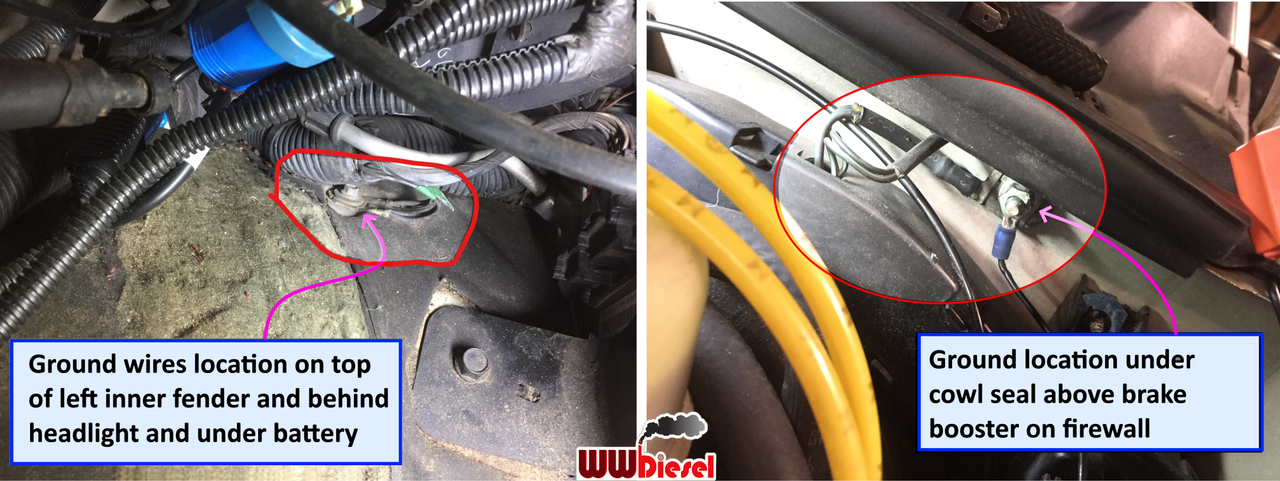

First thing to check with any electrical problem on these vehicles is the grounds! see picture
If it is an 06 model, check where the wiring harness goes behind the fuel filter head, there is a known problem of wiring chaffing in that area on these models. :banghead:
You should also check the plug in connection on the rear of instrument cluster.
Next, check all fuses with a testlight or ohm meter and make sure you have none that are blown or bad. (you can't just look at a fuse and tell for sure if it is bad or not)

Thanks for the specifics of the grounding locations. I did previously check the fuses with a multimeter. I also check the plug in the back of the instrument cluster.
