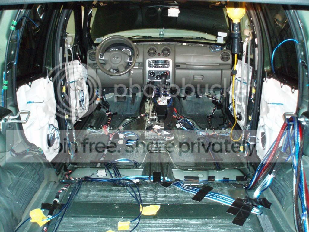

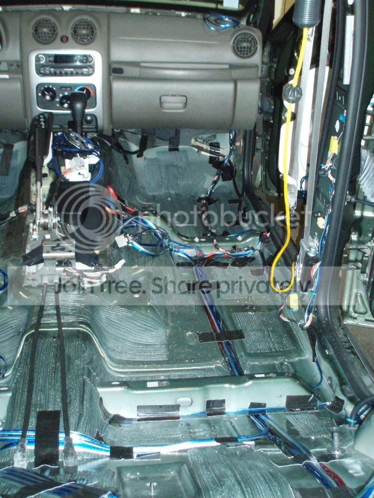

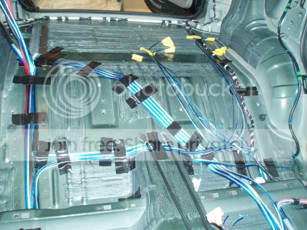

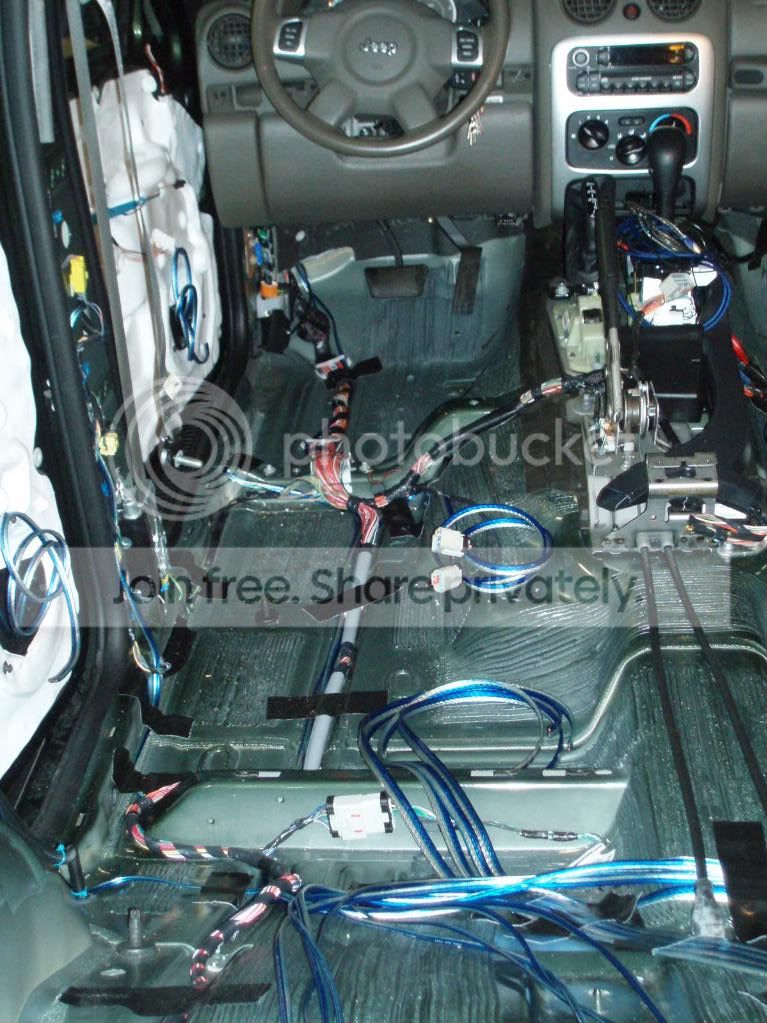

okay, sorry for the delay...but here are the pics, as promised:
I have too many to post here so if you want to see more check out the whole album:
http://s336.photobucket.com/albums/n355 ... ed%20Pics/

I reinstalled the white plastic layer over the sound damping sheet on the doors for now, but I can always remove them if it turns out to be a problem. Thanks for the heads up though.
...and yeah, I still have those wire covers/floor plates. In fact, I even coated them with 2 layers of spray on sound damping material.

haha...nobody I have had as passengers can find the switches to use the rear windows anyway.
What thickness of sound damping sheet did you use?...and you laid down 2 layers on the whole interior?
I currently have a single layer of .072" on the doors and tailgate, with .042" on the rest of the interior (except behind the dash).
I don't have enough material, budget, or time to double up on my whole interior. I figure I will have a little left over and probably double up on atleast the roof. I was thinking that the firewall and roof probably transmit the most outside noise. Which areas would you say are the most critical?...so I will know where else to apply the remainder as a second layering.
I'm hoping the extra spray-on damping I used in the cavities will make up for not using multiple layers of damping sheet.
I am going to finish the rest of the damping tonight, so I should be reassembling the interior across this weekend. I am sure I will have more mysterious "extra" parts to ask about. :roll:
Also, does anybody have advice for mounting an amp on the passenger rear seatback? Does the sheetmetal pan span across the entire seatback? Do you think I should drill and tap it or just use self tapping sheetmetal screws?
Also, I am considering using spacers/standoffs underneath the mounting screws/bolts to make sure I get airflow around all sides of the amp for cooling. Am I being too cautious?
Thanks again.

wow Frosted, you went all out. My setup pales in comparison to what you did. You said that you barely noticed a difference after all that you used? I hope I can atleast notice some difference from what I did because it's sooo much work. :roll:
I have one sheet of thick and almost 2 sheets of the regular material left after covering everything once. I am going to do the roof again and the rear wheel wells because you said those are important, but will dread the wheel wells because they are such a pain to do!!!
I'll try and post some pics of the completed job tomorrow night.
Thanks again for your advice and guidance throughout all this. :)
