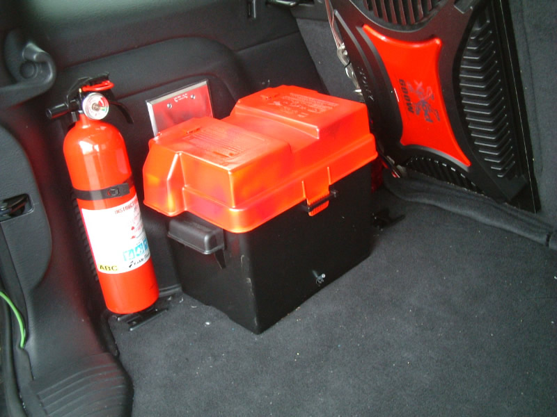

Just wanted to know if anyone has mounted a second battery in their Liberty's? I want to install a few extras, CD, Ham radio, power inverter, and thought another battery might help out.

I have my second battery mounted in the back. Its a optima yellow top.

How you wire it in? Is there a junction box or anything?

I have a wire going from the (+) of the main battery to a 200 amp relay, under the hood, through the firewall (there is a hole there that you can use) to the (+) on my second battery. The second battery is grounded to one the bolt that holds down the seat belt.
I dont currently have a junction box, but all the equipment hanging off the second battery have their own inline fuse.
